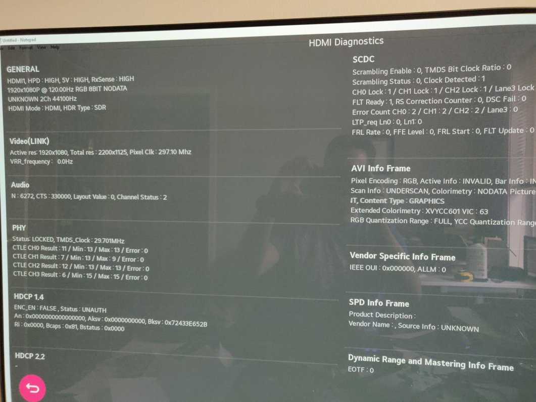

Unless I'm reading this completely wrong, I'm getting 1080p/120hz/RGB no problem? I can do the same with 1440p. This is no adapter, just HDMI port on a 2080Ti.
But does it look like RGB on test patterns? For example the Rtings one: https://www.rtings.com/images/test-materials/2017/chroma-444.png the last 2 lines are the biggest offender. They only look perfectly clean with RGB.
1080p 120hz RGB is definitely not RGB for me (1080 ti right now if that matters), the TV downsamples it to 4:2:2 (which is not nearly as bad as 4:2:0 but can still be an issue). The last line of that picture I linked is a bit fuzzy. Switch to 1080p 60hz (or 4k 60hz or 1440p120hz) and it looks perfect.

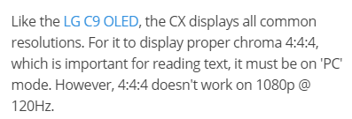

The TV may report RGB but that doesn't mean it's actually outputting it. From RTINGS:
Yeah I just tested this a bit. It seems that all the resolutions NVCP considers "PC" do RGB properly above 60hz (except 3840x2160+ of course because of bandwidth limits). All the "Ultra HD, HD, SD" switch to 4:2:2 above 60hz (including 100hz, 110hz, and 119hz. I didn't try making custom resolutions between 60hz and 100hz.). It seems like it's something that might be able to be gotten around with EDID trickery, or the "PC" 3840x2160 that you currently use to do 120hz/4:2:0 will just work at RGB with HDMI 2.1 bandwidth. If that last part is the case, that might be a big fuck you to C9 owners because I don't think they have the "PC" 4k resolution...
