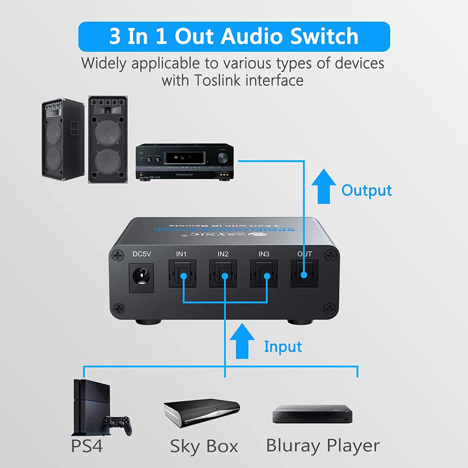

... but yes, you can just run toslink/spdif optical from your pc to the receiver and avoid the TV. I think my receiver has 2 toslink/spdif optical audio inputs. You could also get a toslink switch if you need to have more inputs. I used to use a cheap manual wheel style one at one point where you would just spin a bar in the middle to whichever input you wanted. I kept it within reach at my chair.
There are more modern toslink switches with a remote like this one for ~ $20 usd, or similar ones from monoprice:
https://www.amazon.com/eSynic-Switcher-Aluminum-Supports-Dolby-AC3/dp/B074W8DG3P/
Toslink isn't good enough for me since this TV is supposed to have eARC for uncompressed hdmi audio. eARC uncompressed hdmi audio without having to resort to fake/phantom monitor tricks is one of the features I looked forward to with upgrading to a hdmi 2.1 display at my pc. There are a bunch of games that support ATMOS sound now and I'll be playing some movies off of my pc via plex with uncomrpessed hdmi audio (7.1 atmos) tracks either viewing full on or while I am more focused on my other monitor(s) in the array.
Uncompressed hdmi audio would normally be the only reason you'd absolutely need to run HDMI audio through the tv ever...
- outside of the easier 1 shot audio source switching at the same time as the video source with the TV's remote ease of use consideration. The optical switch method instead uses the TV remote to switch the video source as normal, and then the audio switch remote to switch the audio source.
However, newer consoles are omitting toslink/spdif optical audio outputs so that creates a problem again since they have to use the TV's toslink output if you want to run toslink to your audio device. You'd be stuck with that unless either someone makes a usb audio dongle for the console (like the astro mixamp / mixamp pro used to do on the older consoles), or if perhaps an existing usb audio device works on newer consoles.
