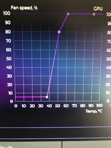

I'd take the (aftermarket) 2080 Ti because the Titan cooler is meh, the TDP is limited, and there's no 0% fan mode, and the BIOS is hardlocked to a minimum fan speed of 41% which is atrocious. To me quality of life is better than 3-4% higher max fps.
I use EVGA Precision X1 software to custom curve fans on both my Ti and Titan RTX - neither are hard locked - Stock (founders cards) the Titan runs fans far less hard (its lower base clocks at that too than Ti) - max fps in most games are 5 to 8% up to as much as 12 to 14% faster before getting into custom fan curves - Games like CoD BO4 and BF5 The Titan RTX min. frames on 240Hz monitor are far better in real games (50+ frames) - Hate Titan for whatever reason you may, but make no mistake (price aside) its a beast - EK (and others) have after market coolers, Arctic has after market air cooling (unless case air flow sucks, using EVGA X1 or the like software for fan curves gives nice boost, never has temps been a problem for me).
Not sure if you're getting bad data but from what I just looked at the min fps (0.1%) is virtually the same (1-5 fps difference) between the titan and 2080 ti. That was multiple games, multiple resolutions, etc.
-------I'm not able to lower my idle Titan RTX fan speed with either Precision or Afterburner to a satisfactory amount. Can you show a screenshot of you running the card's fan speed on either software at say, 15% or so? Not saying I don't believe you, maybe I am doing something wrong.
I had to remove all my NZXT software (that was the only thing I've ran into that actually with it loaded, my fan rates locked at 61% - don't know why, and never looked into it further). If you really are having issue with X1 (use latest version, or v3.19 or newer) I can PM you after I'm done with couple hardware parts and 2 software (game) being tested under NDA on this system (once I'm done I'll pull Titan RTX and put back into my TR2950X system) - But lets face it, screen shot is going to do zero for you (help) if your really having problems.
On opening screen (X1) software - go to lower left (Fan Speed), check that its on auto (I like to click chain link so custom curves affect both fans without having to set both fan curves) - click arrow (temp tuner page), click again for Fan Curve Control Screen - click box fan curve control (should be solid purple) - in drop down select Custom - now bump lines (both of them) up for each temp (I start my curve at 30c with bumps at 50c and 60c and 90c) - click apply - then click setup in upper right, in setup click start with OS, I check start minimized, apply - you should hear fans ramp up or down if you changed them - its as simple as that - of course they will not go lower than you've set them for temps picked.

Huh? That's a very bizarre canned response. You made a claim that there's no minimum fan speed. On both software I cannot reduce the fan speed below the minimum threshold because there's a dotted line telling me that's the BIOS minimum. According to you, there is no minimum, so if it's so easy to lower the fan to 15% or 0% for you on a reference card you should be able to substantiate that claim. I'm gonna guess either A) you can't substantiate your claim or B) you are running on a modified BIOS.
Compare min. frames 1080P - Tom's, and number of others... I haven't seen a review bench BO4 (Ti vs Titan RTX) and only couple that have done BF5 - Titan is strong on min. frames in these games on 240Hz monitor at 1080P.
Of course you can't... its not bios lock - the fans will not run slower than temp curve/speed chosen - and as get up into 60c to 80c range it will not let you go to zero as result (simply burn the card up), lol... Clearly you're not looking for real thing here and its more of bait and bitch sort of thing (I'm not interested). Of course the SAME applies to the 2080 Ti as it also does to the 2080.
