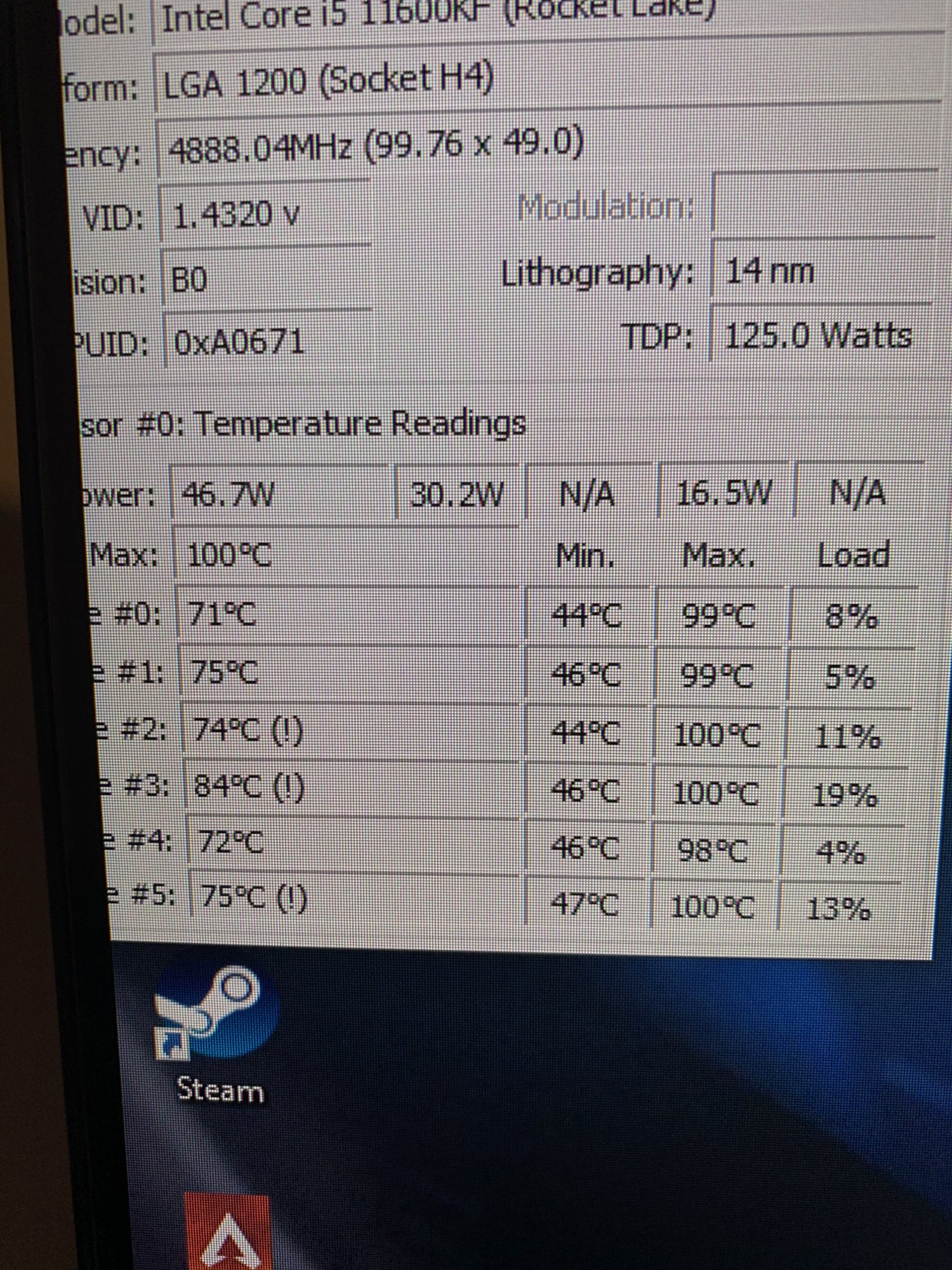

My neighbors kid bought a cyber power pc with the mentioned cpu. He told me it is constantly shutting down. I had him install core temp and send me a pic after 10-15 minutes of gaming. It shows the cores hitting 100c. Looking it up on ark it looks like 100c is the max for that cpu and it’s shutting itself done. It has some dinky ass cooler on it. I pulled it and the thermal compound looked good. I removed it and put some mx7 or whatever I had laying around. I’m gonna tell him to return it to Best Buy as he has only had it 4 days. The fan rpm never leaves ~1700rpm as it heats up.
am I right to say those temps are not right?

I am betting the motherboard is not configured to respect Intel's stock spec for the CPU. if it were, the CPU should be throttling itself, rather than being allowed to reach its thermal limit and shutdown.
However.....no Rocket Lake being used in a performance focused situation, should be cooled with a stock cooler.
I don't think they should return the system, I think you should help them find a decent cooler and also go through the motherboard configuration, to optimize some settings. If they return the system, the chances of getting anything else, are slim.

More than likely the board has an intel specified tdp. What motherboard do they have?

it almost sounds like the mobo has cpu fan set to quiet mode, and cpu limits disrespected.
I know some mobo brands have that tdp boost.
you should have asked him to use hwinfo64 to look at tdp while it was in the high 90s.
