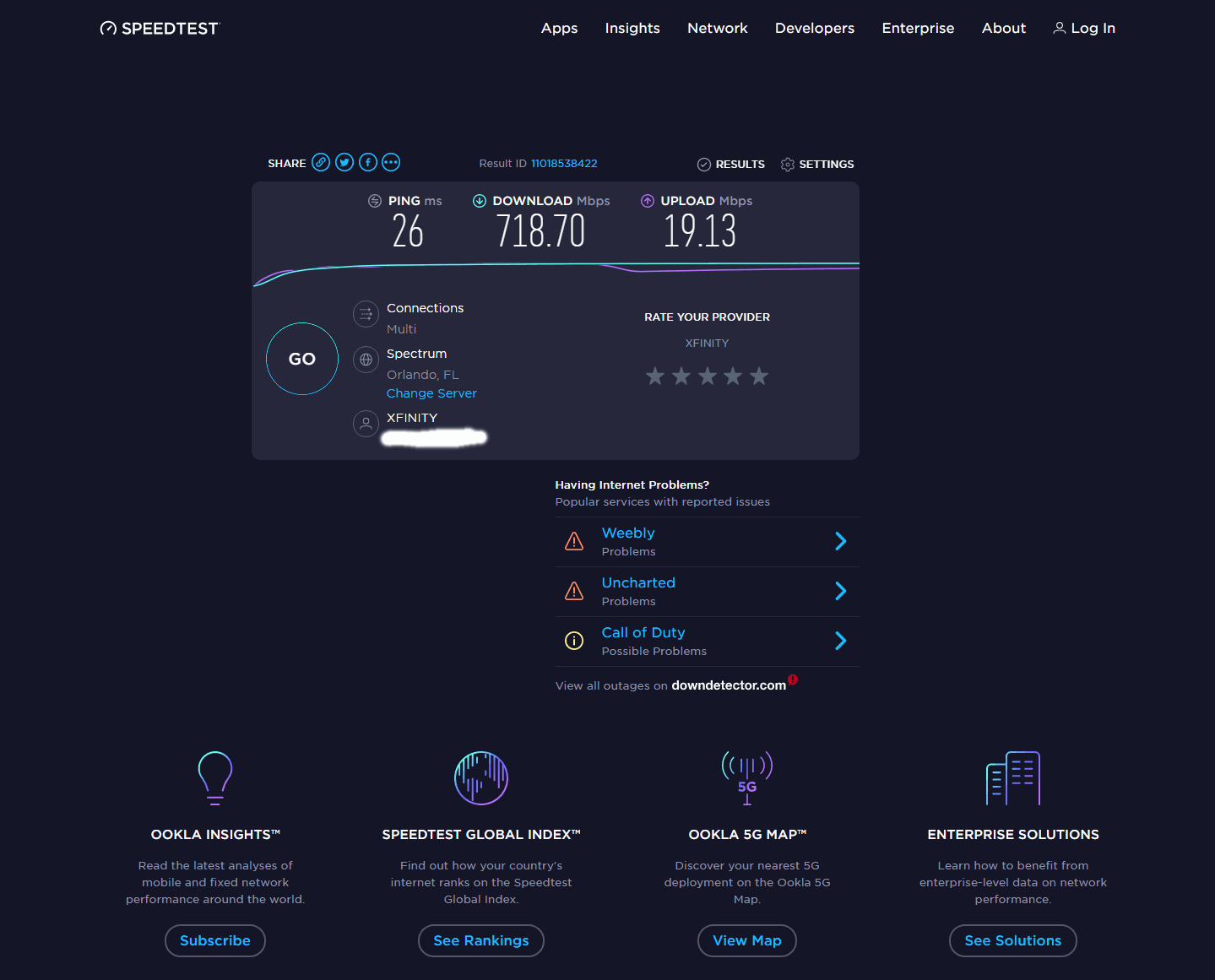

1.) Comcast lists a service with 1200Mbit down. I have googled my ass off but cannot for the life of me find what the upstream is. Anyone know?
For my 1 Gb/s service, it's ~35-40 Mb/s up. Sad, but still far better than the ~10-12 Mb/s lower-tier plans provide. (I'd gladly trade half my download for >100 Mb/s upload.)

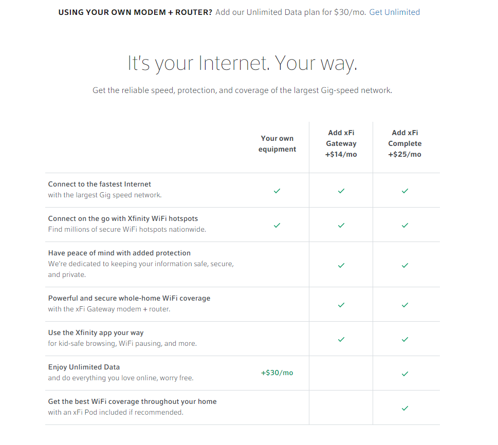

3.) So, Comcast now has a 1.2TB per month data cap after which they start charging overages. This will never be sufficient for me. I seem to average about 5 times that. As much as this pisses me off (ground based data should never under any circumstance be metered) I vaguely remember there being options, like paying more for unlimited, but I can't find anything about it on comcasts page. Does anyone know what it costs to take a 1200mbit/s plan and turn it unlimited?
Not too sure on this. I want to say there's a $50/month cap on overage charges? Going off memory here, not something I've had to do.

3. I remember reading that the gig plan is automatically unlimited, but I've also seen an offer for something like $100/mo for any plan to be unlimited. You get two 'freebies' on going over the 1tb cap, but that won't last you long for sure.
4. Easy-peasy--get your own modem and you've already got your pfsense for routing. Their default unit is a combo unit, but you definitely don't want that because of the hidden hotspots--those eat all sorts of airwaves as there's actually 3 hidden antennas/ssids. At one point I fought with shutting them off all the time, until I just got our sb6190 and an archer c5--smooth sailing after that. Arris has come out with a modem with a 2.5Gbps port, but honestly, it's going to be a waste if you need upload bandwidth. Pick up some used sb6190s for next to nothing (because everyone is scared of the supposed 'puma' chipset issue--reality is that it is a non-issue as I have 2x sb6190s obtained from two completely different sources, one being new, and they are the latency sensitive ipsec link I'm typing over right now and if there were any issues, my typing at 140wpm spikes would have definitely been an issue.)
Personally, I would think of it this way--you can have multiple accounts for multiple purposes with different public IPs. One for the house traffic, one for uploads, one for hosting, etc. They all come on one bill and are broken out by account (last I remember seeing it since I had 2 accounts at one point when we moved from one city to another). Hope this helps! :)

Dismal Uploads, at least for this one test. Anyways Comcast has an unlimited Data plan you can add onto their Internet plans, she told me unlimited was an additional $10/month which seems reasonable if you are hitting those downloads. We were not close so I didn't bother.

Just letting you know that if you switch from their modem/wifi combo for your own, they charge *more* money per month, especially for unlimited.
It's such a ridiculous limitation that I can't believe it's legal, but there it is. Renting their modem + unlimited would have been $105 a month for me, having my own modem + unlimited is $120. (All at 1gb/s down)

It's not some hidden fee, they advertise the price increase very blatantly. Your own equipment is $30 more a month for unlimited.

TheSlySyl That is exactly the sheet I was thinking about. If you get xFinity complete it includes a modem / router / wifi all in one unit and unlimited data and costs less than just paying for unlimited. You might need to have gig blast (gigabit) in order to get that deal though, I'm not entirely sure.
