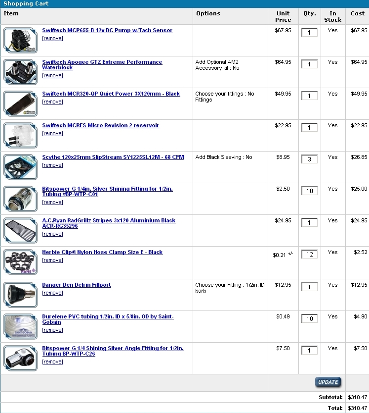

Here is the version 1 of my list
swifttech MCW60-r2 gpu water block 46.95 X2 (93.90) http://www.petrastechshop.com/swmcgpuwawg81.html
Swifttech full cover heatsink 28.95 X2 (57.90) http://www.petrastechshop.com/swgtfuhefmc.html
Swifttech gtx200 mounting hardware 5.99 X2 (11.98) http://www.petrastechshop.com/swgtx200moha.html
Swifttech MCR-320 Rad 53.99 http://www.petrastechshop.com/swmcqposerab1.html
Swifttecg MCRES-MICRO Rev2 25.95 http://www.petrastechshop.com/swmcmirere.html
Fan speed?? Yate Loon Mediums 6.99 X3 (20.97)
things Im not sure on:
Tubing?
Fittings?? Type/kind/material??
PUMP????

So is this a good start? Sidewinder doesn't have any coolers that work with the 280s
did I miss anything? I think.. I got everything to fit with 1/2 ID tubing.
You'll need anadditive for your distilled water. The additive kills algae and reduces corrosion in the metal.
I use this, it looks like car antifreeze:http://www.sidewindercomputers.com/hyexduco.html

I am going to go with this for the video cards because no one else has all these parts in one place.
http://www.crazypc.com/store/merchant.mvc?Screen=PROD&Product_Code=PX9363R
I updated my pic above as I updated a bunch of stuff.
Now.... If I can get the wife to realize that 450-500 dollars is not a lot of money to do this. She will certainly think I am crazy for this.

I wouldn't get Slipstream fans for the radiator, I'd stick with Yate Loons, they tend to have better static pressure and thus better radiator performance.

Ok, so I am ordering everything listed here
http://www.hardforum.com/showpost.php?p=1034071748&postcount=15
minus the fans
I am getting the CPU coolers and fans from Crazy PC.
I can't believe I am finally going to do this...... I still fear the water at the moment. I really hope everything can fit in the case how I want it to other wise end up with some external stuff.
I also hope 10feet of tube is enough (should be)
So one last time, everything I listed will work together and be ok? I am using 1/2" ID tubing, is that the best option? Will the pump be good enough for my tall beast of a case? Is there ANYTHING else I need to consider before doing this? Are my clamps good enough for this? (Size E)
Do the fans need special screws to attach to the radiator?

Don't use a right angle fitting, it is unnecessary and will restrict flow. The tube will bend no problem.
