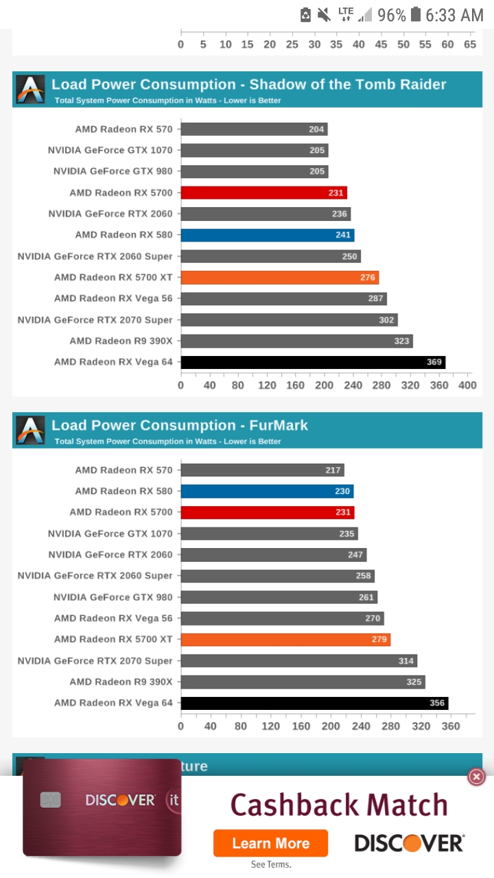

I've seen people use the SF450 gold with a 2080 I estimate I'll be at around 69%/300watt max used of the 450w available. I've seen the SF450 gold tested by I believe Johnny guru and he got around 500w from it if memory serves. Side note the screen shot the pc is using a intel 9900k OC to 5Ghz I believe.

I dont mean to argue and if I'm missing something or not seeing what you guys are trying to tell me I want to understand! So after doing some more looking into my question. I still feel confident that the sf450 platinum psu will be about 100w above what I'll need. As the ryzen 5 2600 shouldn't pull more than 85w from what I've been seeing. The rx 5700 red dragon power draw should be between 160-185w. MB and other stuff combined maybe 55w. So that's a total system power draw of around 315w give or take. I apologize if I'm beating a dead horse. I sincerely want to understand if I'm missing something. Thanks in advance!

I contacted corsair and powercolor directly.
Corsair said that I'll be fine. If I wanted to OC they used the words "juice up" they recommend a 550W psu. I asked if I'll be good long term at 300-350w they said "that is fine" fine is better than ok.
Powercolor said silent bios mode consumes 8-13 less watts. They also said max power draw is 175w.
I have emails as my proof. Thanks again you all.
