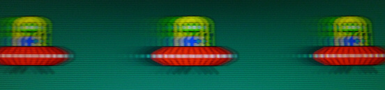

On your LG OLED, view www.testufo.com/eyetracking -- the top and bottom UFOs still looks different.
That's because of sample and hold. Your eyes are moving (analog) to track moving objects. As you track the moving UFO, your eyes are in different positions at the beginning of a refresh cycle and at the end of a refresh cycle. If a refresh cycle is on the screen continuously for a finite time period, you see display motion blur.

2. Stutter is Persistence Too! There's a Stutter-to-Blur Continuum (DEMO)
Did you know stutter and persistence motion blur is exactly the same thing?
Stutters is caused by persistence too.
*Here, I will talk about perfect frame paced stutter (e.g. regular stutter of low frame rates like testufo.com#count=6), I'm ignoring judder, harmonic/cyclic stutter, or erratic frame rates for the purpose of this explanation
Persistence = object staying in same position, regardless of low frame rate (stutter) or high frame rate (blur)
Stutter = slow vibration = like a slow vibrating music string (string looks shaky)
Blur = fast vibration = like a fast vibrating music string (string looks blurry)

Flicker is only one part of the motion equation.
There are multiple orders of magnitude involved (healthy error margin, but demonstrates massive orders of magnitudes of the different detection thresholds involved)
~10 -- humans stop seeing slideshow effect and begin to perceive motion
~100 -- humans stop seeing flicker. Also stops seeing stutter in perfect framerate=Hz.
~1000 -- humans stop really noticing display motion blur (persistence)
~10000 -- humans stop really noticing stroboscopic/temporal effects (gapped motion effects, temporal dither effects, etc)
Some humans are only sensitive to 1 of the above, others are to all. There are people who get eyestrain from DLP temporal dithering effects (1440-2880Hz per-pixel PWM).
Note: These are crudely simplified orders of magnitude, and can be off quite a bit, but this illustrates there are a whole Pandora Box of artifacts that are far beyond flicker fusion threshold)
One example is the famous stroboscopic effect; but is also visible in games, far far beyond the flicker fusion threshold:
And when you add PWM to that, these things become more pronounced, and becomes more bothersome to some. Can be more pronounced with wide-FOV, very-bright, sharp-primaries, wide-gamut light sources (aka PWM-laser-illuminated projectors)
This even still happens at 1000fps 1000Hz -- the finiteness creates differences versus real life. So in many cases, even 1000Hz is not retina refresh rate. Now, that being said, 4000 pixels/sec at 1000 stroboscopics/sec still creates steppings every 4 pixels. Even 1000fps 1000Hz can still end up doing that, if you don't use GPU motion blur effect intentionally to hide stroboscopics (that's why I said sometimes the dreaded GPU motion blur setting is sometimes another persons' "ergonomic feature" when people have more eyestrains from stutters or stroboscopic effects). Although Blur Busters are all about busting motion blur, we also believe in adding motion blur when it's the lesser evil -- Right Tool For The Right Job.
For a perfect Holodeck (~16K 180-degree VR), the retina refresh rate can be well over >20,000fps 20,000Hz, to cover all above, if you don't use eyetracker-compensated motion blurring. In the diminishing-curve-of-returns stratospheres, larger geometric jumps are needed (e.g. 240Hz -> 1000Hz -> 4000Hz) to be human-noticeable (like blur differences of 1/240sec SLR photo versus 1/1000sec SLR photo). Assuming the blurring/stroboscopics at sufficient motion speeds in pixels per second, are creating artifacts bigger than the human angular resolving resolution. For example, 1ms MPRT (requires 1000fps 1000Hz to do strobelessly) still creates 10 pixels of motion blur on an 8K display at 10,000 pixels/sec scrolling motion, so even 1000fps 1000Hz is not "retina refresh rate", for that resolution. Higher resolutions amplify Hz limitations. As a lot of motion artifacts are a result of the finiteness of refresh rates & frame rates;, and can never perfectly match real life.
Strobing, in fact, is a motion blur reduction band aid, and that's why we're big fans of future brute framerate-based motion blur reduction (sheer fps at sheer Hz), since real life doesn't strobe. Since real life is analog (aka infinite frame rate), the only universal whac-all-mole method for finite temporal behaviors is to get as close to that as possible (such as via brute framerate and Hz).
The LCoS flicker only seem to happen with laser-based LCoS. I don't see any flicker temporals on the HID/LED based 3-chip LCoS, since LCoS itself doesn't flicker noticeably, but the illumination light source can. Aslo, fortunately, you don't seem to be motionblur-sensitive (some of us have headaches from display motion blur), and you seem exceptionally sensitive to so fortunately you can try testing out non-laser-lit LCoS technology -- like a HID/LED-based 4K Sony SXRD projector, or similar. Those are practically zero PWM, no per-pixel PWM, no backlight PWM, and is pretty eye-pleasant, comfortable for viewing for 8 hours on end by my eyes. Just not as good blacks or HDR. You do give up color gamut of lasers, which can sometimes be problematic for the comfort of some human eyes (it's amazing wide gamut if you're comfortable with the image, though). Another option is LCD projectors, but those have certainly stagnated -- I used to have a Panasonic PT-AE2000U projector and it was super-easy on my eyes -- but I don't see any new worthy LCD projectors at the moment. Laser is the big thing going on, looks amazing, but that isn't easy on everybody's eyes.
Displays are certainly vessels of disappointing compromises, and there is no Holy Grail to be found. But some compromises can get really good (high-framerates on VRR OLED is really lovely to many eyes).
You should check my article titled, "The Stroboscopic Effect of Finite Frame Rates", some motion artifacts which is human visible to well over >10,000 Hz in some conditions!
