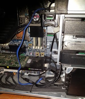

YOU CAN SEE THE ATTACHMENTS HERE BELOW, OR THE ATTACHMENTS IN HP FORUMS

Yes, it is always going to be better to buy new stuff, however, it's not always practical within your budget.
You can still use that video card in that computer if you wanted, and it would probably provide you with a boost depending on what exactly you do while video editing, graphics design, and photo editing and whether or not your programs leverage the newer technology in the video card.
You might need a new power supply with two 8-pin connections. What other connections are available on your PSU? You might be able to use an adapter if you have a couple 6-pin connectors or something like that.

Your PSU is a standard 800W for that model. So, it has enough to power everything. Your z620 has a pair of power connectors for the graphics cards, one's not being used. Are they 6 pin? If so, not the best for your setup as it looks like your card is a dual 8 pin. There are adapters that may work to get you going. Up to you as to whether its worth it or not. Bottom line, you can get the 3060ti working with the z620.
A new PC will work better - depending on what you have now versus what you get. It'll be more power efficient, too. Higher single core ipc and better multithreded performance, I'd bet. If you have a really old 4c cpu in that HP then it's an easy decision.
My Z820 has dual CPU's and a pair of 20c processors. So, 40c/80t. The 3060 / ti added Nvenc support and used only a single 8 pin power cable. So, it was an easy install and upgrade.

I think with the help of adapters I can have two 8-pin power connections... Are adapters ok to be used?
E.g.
6pin to 8pin
Sata3 to 8pin
Please provide Amazon.com links for such compatible Adapters...?
matt167
Dec 18, 2016
1,223
If you have one 6 pin, then you can make it work but it’s on the edge. A 6 pin (75w) can be adapted to 8 pin very easy. And then you can get 54w out of a sata to 8 pin adapter. 75w can pull from the slot.. so if you do the math. You would have 204w available with a card that has a 200w tdp. It probably won’t burst into flames but, I’d dial back the power limit of the card just a little
