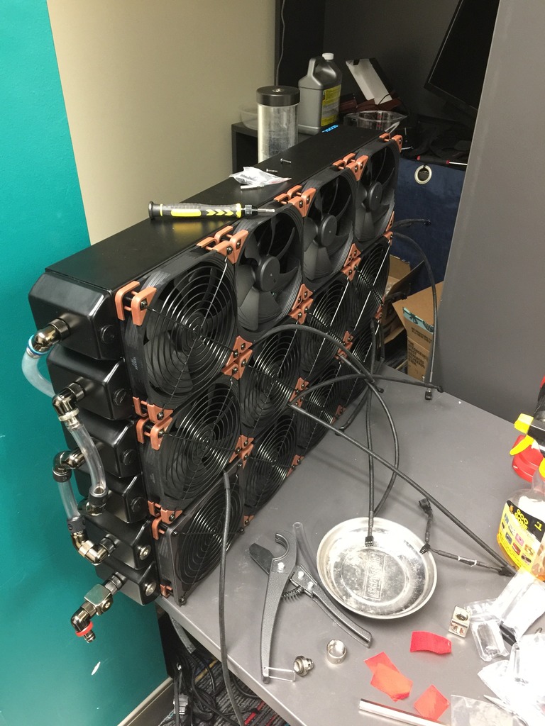

I was getting 227 just with the pump and radiators on the loop themselves. It's an external setup.
I probably have more fittings than most people. No Kinks.
