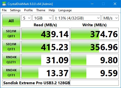

usually they are usb 3.2 and my sandisk extreme pro is very close to ssd speed, ive seen 450/350+ from it. dont know about longevity though, only have it for a year or so.

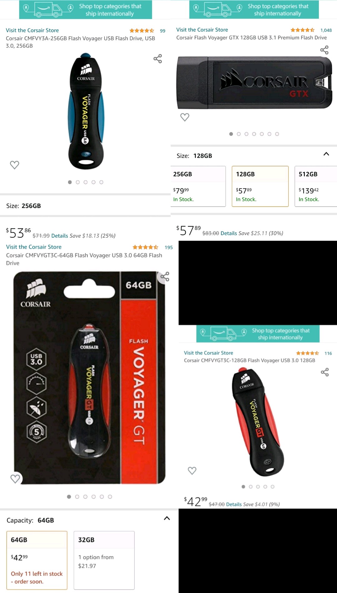

I use a Corsair Flash Voyager GTX and when moving MP3s around I generally get 300-400MB/sec read speeds and ~250ishMB/sec write speeds between it and an SSD.
I believe the ones that achieve much higher write speeds use a more SSD-style controller (and probably better memory), IIRC

Unsure. Seems difficult to find any real details about these drives online. I have the 2nd gen (3.1), most info online is for the 3.0 and is pretty sparse. Seems to be a Phison PS3109-S9 (SSD) controller in the 3.0, and 3D NAND, but that's about all I can find. They definitely had to make the drive physically big/fat to fit whatever was necessary.
xx0xx Check this out:
Is Voyager GTX 128GB superior to 256GB non-GTX that it's worth adding $4 bucks and yet get less storage but better controller?
Also I don't understand why both 64GB and 128GB non-GTX cost the same...
Flash Voyager - Regular flash drive, expect low speeds, old drive
Flash Voyager GT - Regular flash drive, newer revision of non-GT drive, faster (think like 150 read / 75 write, probably not great 4K-Random performance)
Flash Voyager GTX - SSD-controller flash drive, acts like an SSD, much faster reads, writes, and 4K reads/writes
Prices can differ based on seller, availability, sales, etc... lots of factors there
If you want SSD-like performance in a USB drive form factor, GTX is the option to go with (maybe there are other competing products in this space, but I'm not aware of them and haven't used them). All the non-GTX drives are going to be comparable to other flash drives in performance and price.
Consider them two different products, really. The GTX is really just an SSD, its just the "shape/size" that is similar to a flash drive. The GTX's competition is more along the lines of external SSDs, because that's what it truly is
Reliability is more important to me than speed. Is GTX still more reliable than GT?

I am using the Sandisk Extreme Pro I posted above, Windows 10 install takes something like 5 minutes on a modern PC.

I have one of the Sandisk Extreme Pro thumbdrives that has excellent read speed and very very good write speed.
I think this 128GB one was $40.
There is a newer one, https://www.amazon.com/SanDisk-128GB-Extreme-Solid-State-dp-B08GYM5F8G/dp/B08GYM5F8G
Transfer Speed**​
Up to 420MB/s Read, 380MB/s Write
thats the one i mentioned, fastest normal thumbdrive ive ever touched. those look like the speeds i get, slightly better read, slightly lower write but close enough for no complaints.
