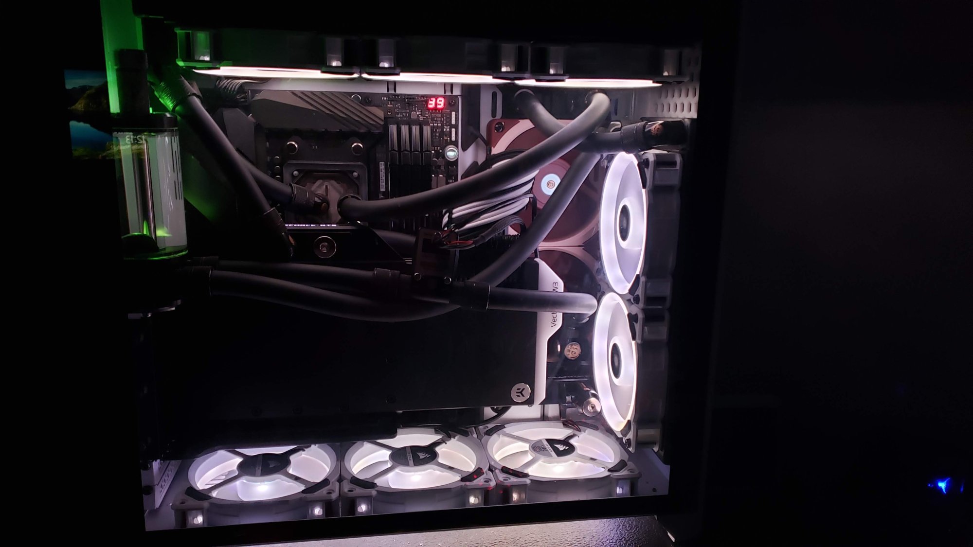

I was going to recommend 14cm mm as well. It's a good medium if you feel 12 is too small and 16 is too big. In an ITX build or even a mATX mini-tower then 14cm mm is probably your best option. 16 would look better in full ATX builds.
EDIT: This build from a Reddit post uses 16mm hardlines in the same case you have and I think it looks good. The ThermalTake Tower is probably large enough that the 16mm won't look oversized unlike in a SFF case such as the Meshlicious or Dan A4.
Also fixed cm to mm.
Been looking at that build lately.
A bit off topic, but why do hard tubing if they're going to make such sloppy bends?
A better question is how do you fill it? I've been trying to figure out how to get mine filled without a dedicated fill tube.
It's a good one overall but I do have to agree with NightReaver that the hardlines are a little bit sloppy in the front. I'm not sure if there were some physical limitations that required things to be positioned and bent the way they are, or if it was just simply poorly planned or executed. I know nothing about hardlines so I can't criticize or pinpoint anything other than the slightly sloppy end result, which in my opinion isn't that bad because it still looks quite nice.
I definitely do prefer the smoother look of softlines, even a perfectly-executed hardline build sometimes looks odd with the sharp angles and bends. Simply personal preference.

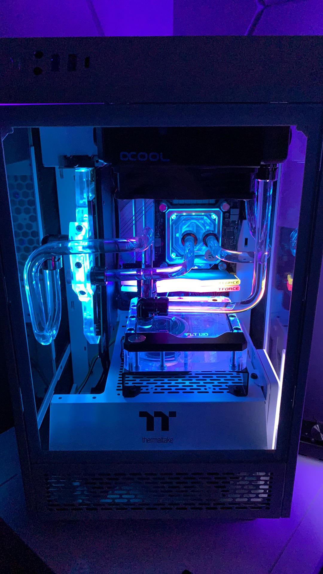

see that fill port...
i use a tube stuck onto a funnel and jam it in there.
edit: now that ive looked closer thats the same pump i have, i just have the stubby res black version. was a steal when i bought it but i wish i got the taller one as the stubby sucks in air from the whirlpool...

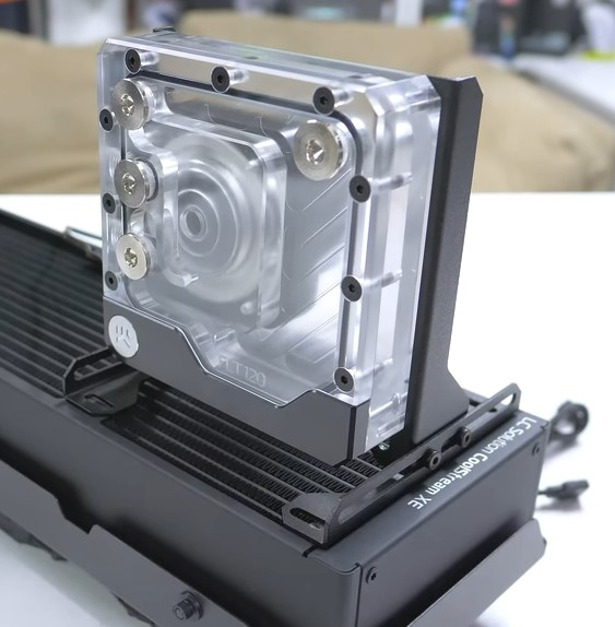

With my set up, the rez is on the bottom, the lowest point in the loop. The next highest is the block, then the rad mounted in the top. However, I'll not be cooling my graphics card, so mine is a much more simple piping.
This is pretty much how I envision the placement of my rez (which is the same as he is using), rad, and block. I'm going to use a more slim radiator,though. Isn't the only way to fill that is with an access point from the rad?

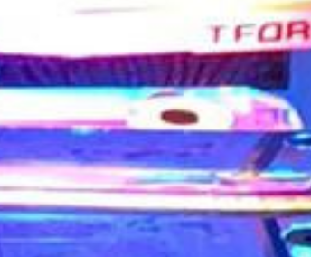

this looks like a fill port with a "flush mount" plug. see the hex head spot?
"see the hex head spot?" Which pixel? lol. My radiator will be in the top. I have a thin 25mm rad picked out, two in fact, since one is no not available until after WW3. The radiator is going to be in the top agasint the case. How would I fill it like that? There has to be some sort of fill tube above the radiator?
hex, allen key, whatever you want to call them, thats whats at the center of those plugs. this is what youre using or planning right?
funnel and tube to one of the fill ports, long enough to be above the rad. thats how i filled mine. fill it, cycle it, fill it, cycle it, over and over with that tiny res... then when its flowing without draining, top it off and let it run open for a bit to let air out, then top it off. you could use a squeezy bottle like suggested before too: https://www.amazon.com/dp/B01G7MSDL...jbGlja1JlZGlyZWN0JmRvTm90TG9nQ2xpY2s9dHJ1ZQ==

That pump/rez is going to lying flat on the bottom of the case, not mounted on the radiator over the top. So the rez is going to be beneath both the block and the rad. Won't the water just run back down into the rez?
not all of it, a bunch will stay in the rads and tubes but thats why i used a long tube(with a fitting on it), just in case.

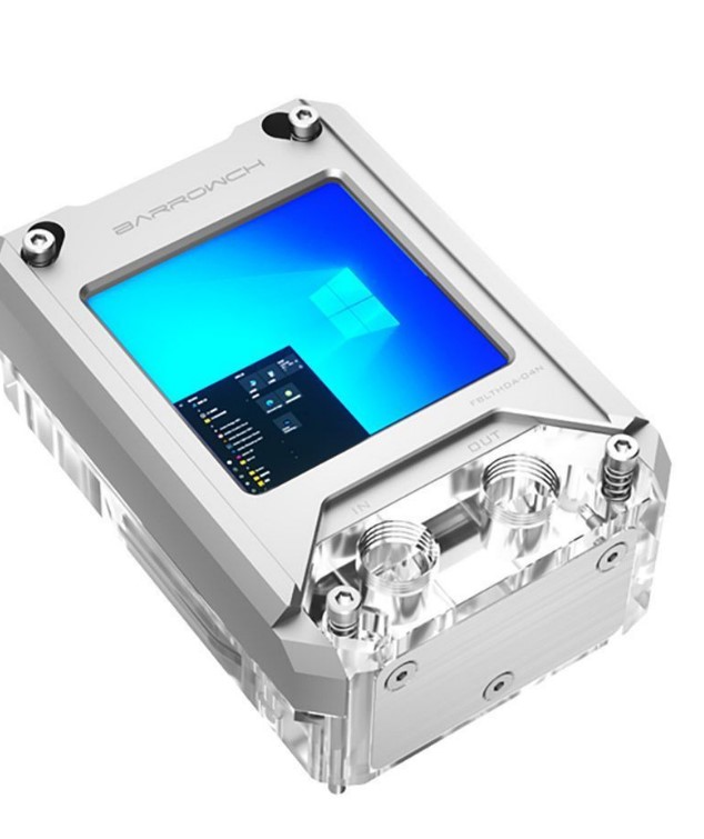

Barrowch AMD CPU water Block with HDMI display screen FBLTHDA-04N V2

Never seen that block before.
Primochill rads aren't very effective so you dodged one there. I do remember that barrow rads are supposed to be all copper but thats about all I recall.
