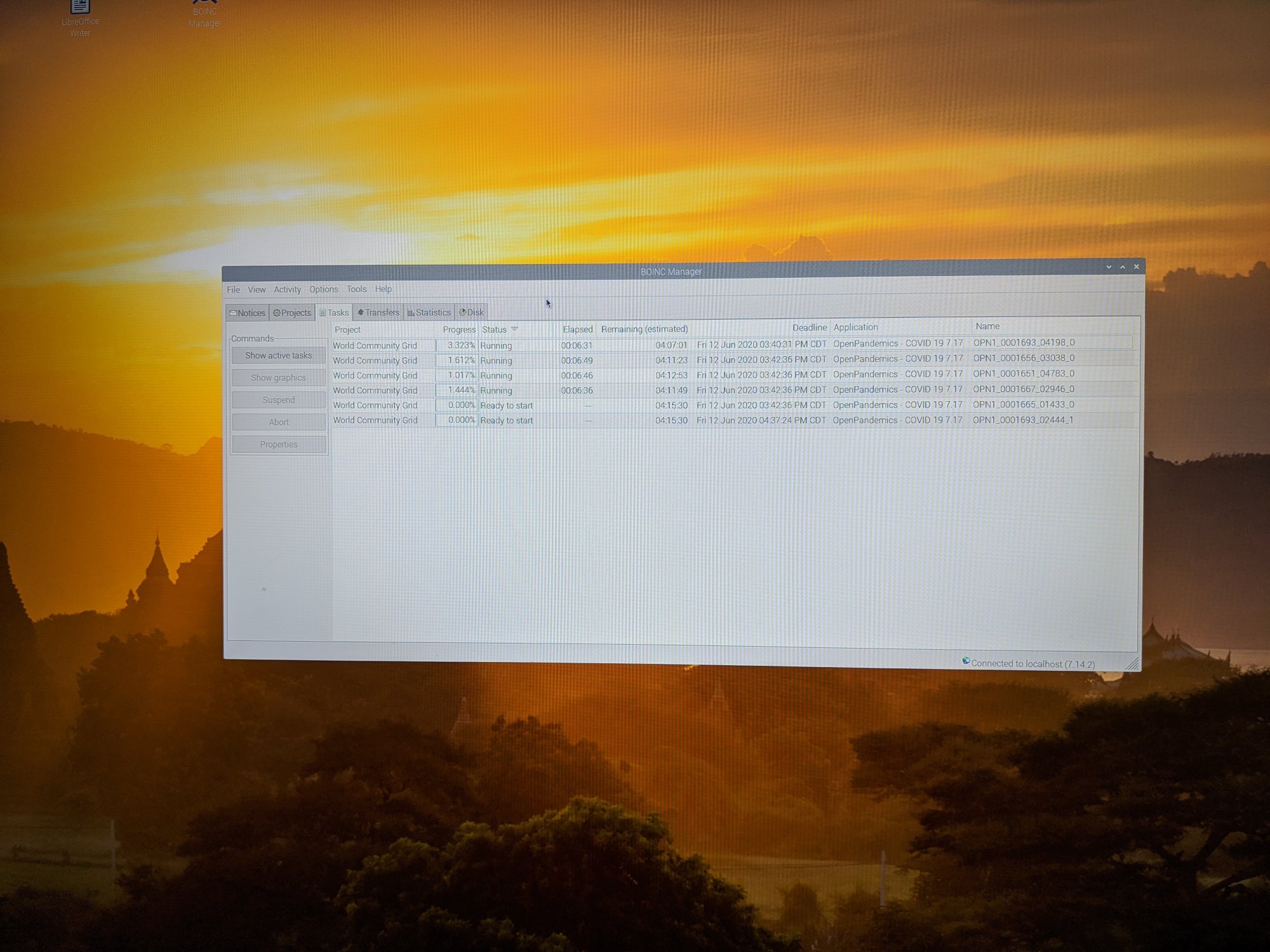

I just double confirmed by setting up my pi2 rev 1.1 on WCG world pandemics (on raspbian), 2x pi 3s (xbian w/ kodi), and a pi3b+ with the 64bit flag set in the boot config. It’s working just fine on all 4 pis.

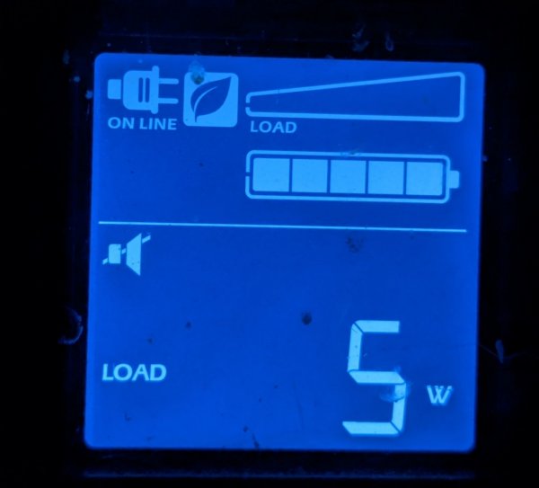

It's up and online, looks to draw between 4-5 watts according to the UPS while running Open Pandemics on 4 cores. Thanks for the info. :)

Another 24 hours and looking closer to a bit over 150 points an hour now.
