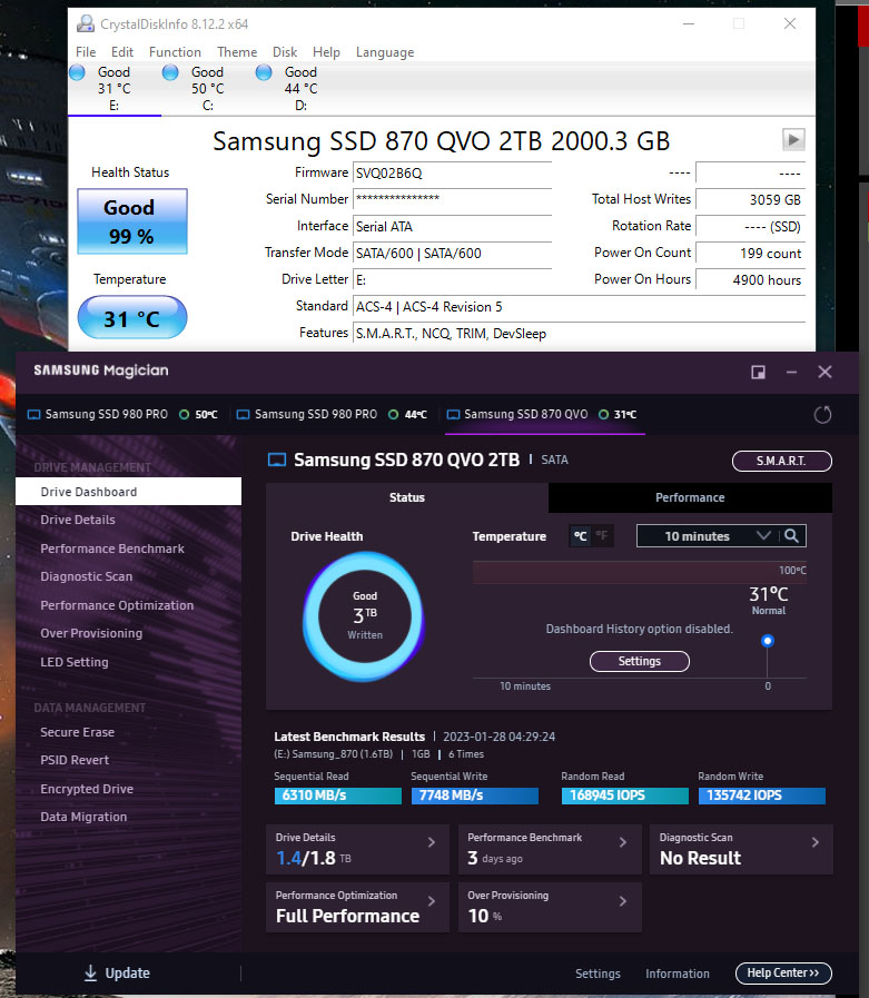

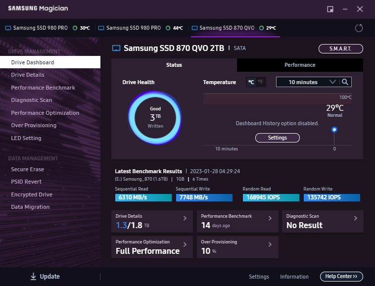

Why is my SATA SSD faster than my 980 Pro NVME?
You tell me? How can you achieve speeds faster than the interface spec? Lol those speeds look like m.2 sata speeds.
I know for a fact that it doesn't read and write that fast in real world use, in fact when writing a large file or files, it drops to 160MB/s after it's written like 8-10GB of data.
