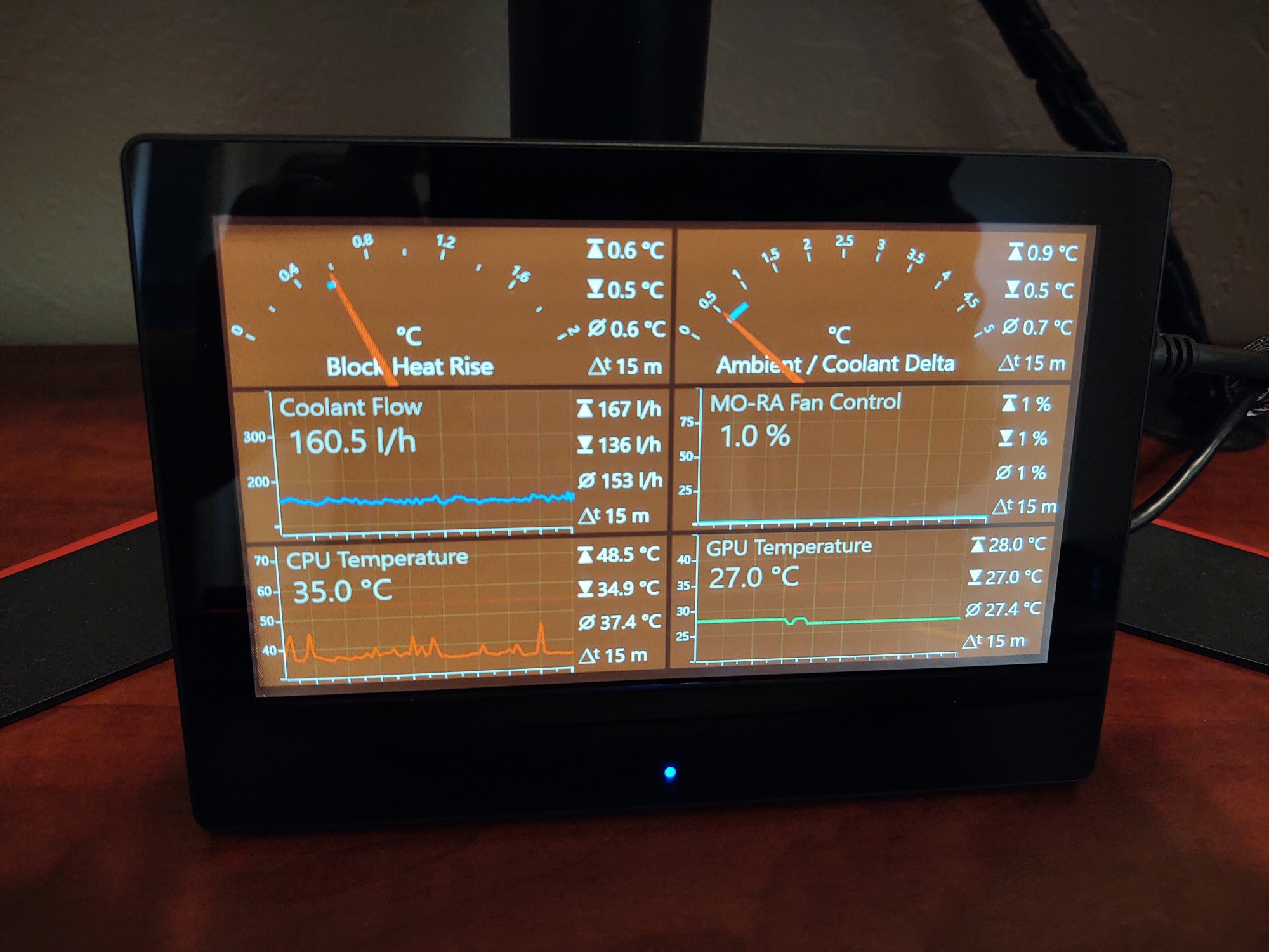

I keep mine running because it manages my desktop readout on my mini screen:
...but if I didn't use that feature I'd likely still keep it installed because I'm constantly tweaking it.
Huh, that's actually pretty neat. I need to add a flowmeter sometime, I just keep putting it off because I hate fiddling with it when it's already setup lol. A couple of PWM pumps would be neat too....do you know if any PWM works with the unit, or just the aquacomputer ones?
