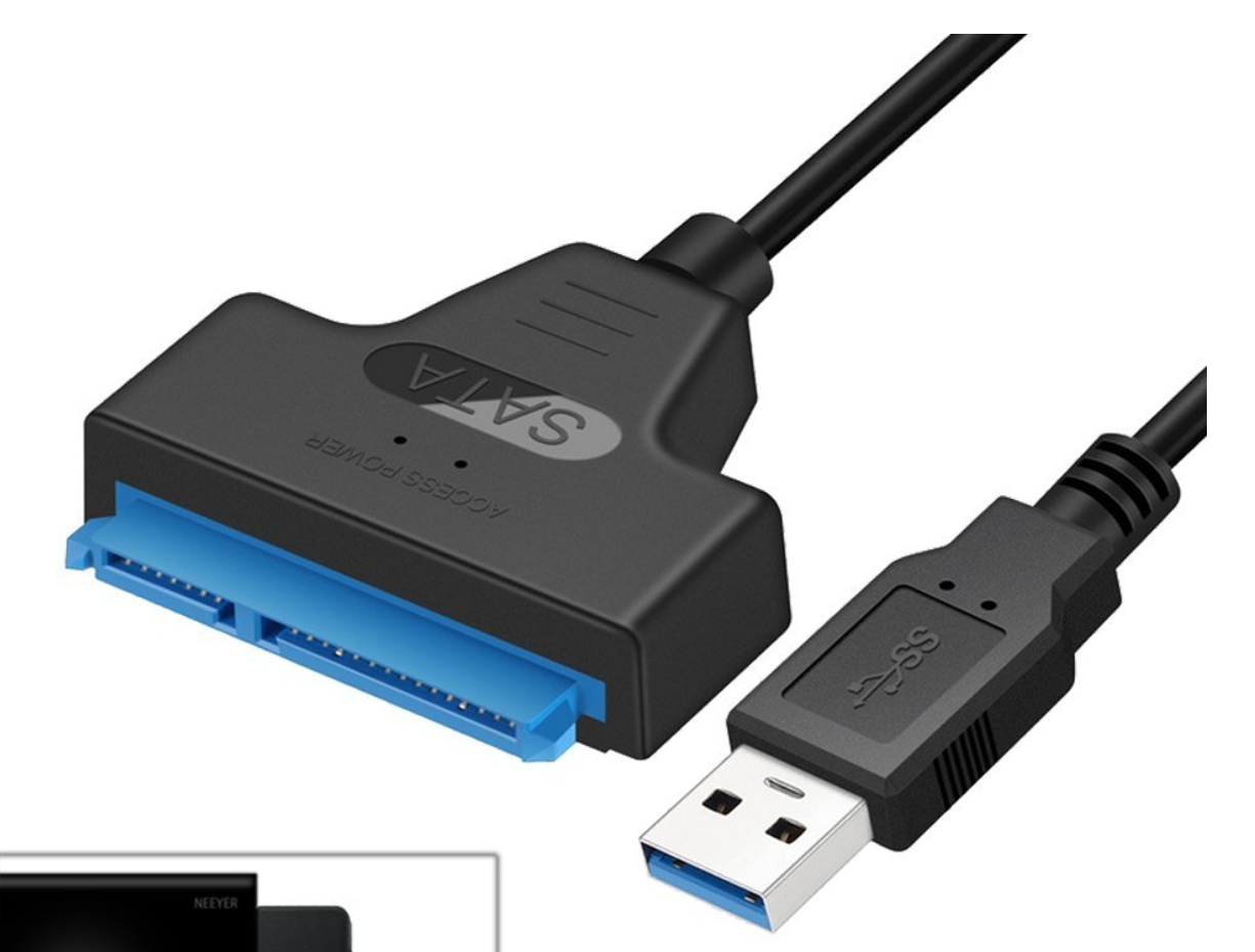

Its the second adapter I try, for the same problem. The first one was enclosure type and the currentis like this:
which seemed to work better at first. Both were generics. Any better recomendation?
