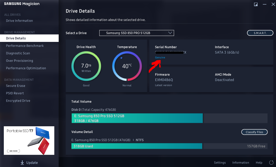

Looks legitimate to me when compared to other images on the web. Load it up with Samsung Magician, it should tell you pretty quickly if it's genuine or not.
Thanks. It looks legitimate, and the speeds are fine, but wtf is with this 26 TB written lol? If it's open box, that means they had it for a maximum of 30 days or so. The power on time in Crystaldisk shows about 99 hours. That means they were writing an average of 250GB/hour for about 4.25 days straight? What kind of load does that, exactly?

Holy shit. Chia maybe? I'm not very familiar with mining/pharming tbh.
Me neither. I'm really confused as to what they were using it for. Just pure stress testing? Hardcore database access? And why did they return it afterwards? It reformatted just fine. Windows installed just fine. Windows has been pretty stable. It benches fine. SMART checks out and the health is good. So I'm not sure why they would return it...
That definitely sounds like it was used for Chia mining
Thanks for verifying, I don't know much about how hard mining hits SSDs. Well, I'm not sure why they returned it then at this point.

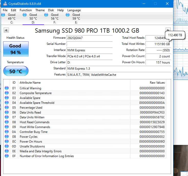

Ya, probably Chia, as this is what mine looks like after plotting 9-10TB's.

Well... I guess it's good that the previous user didn't decide to do a 9-10tb chunk. Jesus.... My health status still says 100%... I've never actually seen an SSD that wasn't at 100%...
Do you actually have decreased space on that now?
Still have 1 TB. I am not sure if you lose usable space. I think it just works till it gets to zero and then the drive switches to read only mode.

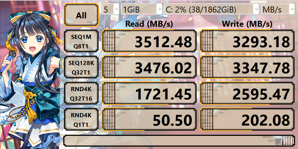

I just finished transferring Red Dead Redemption (about 112 gb) from drive A (also an NVME drive) to this drive. The average speed was about 1.5 or so GB/s.

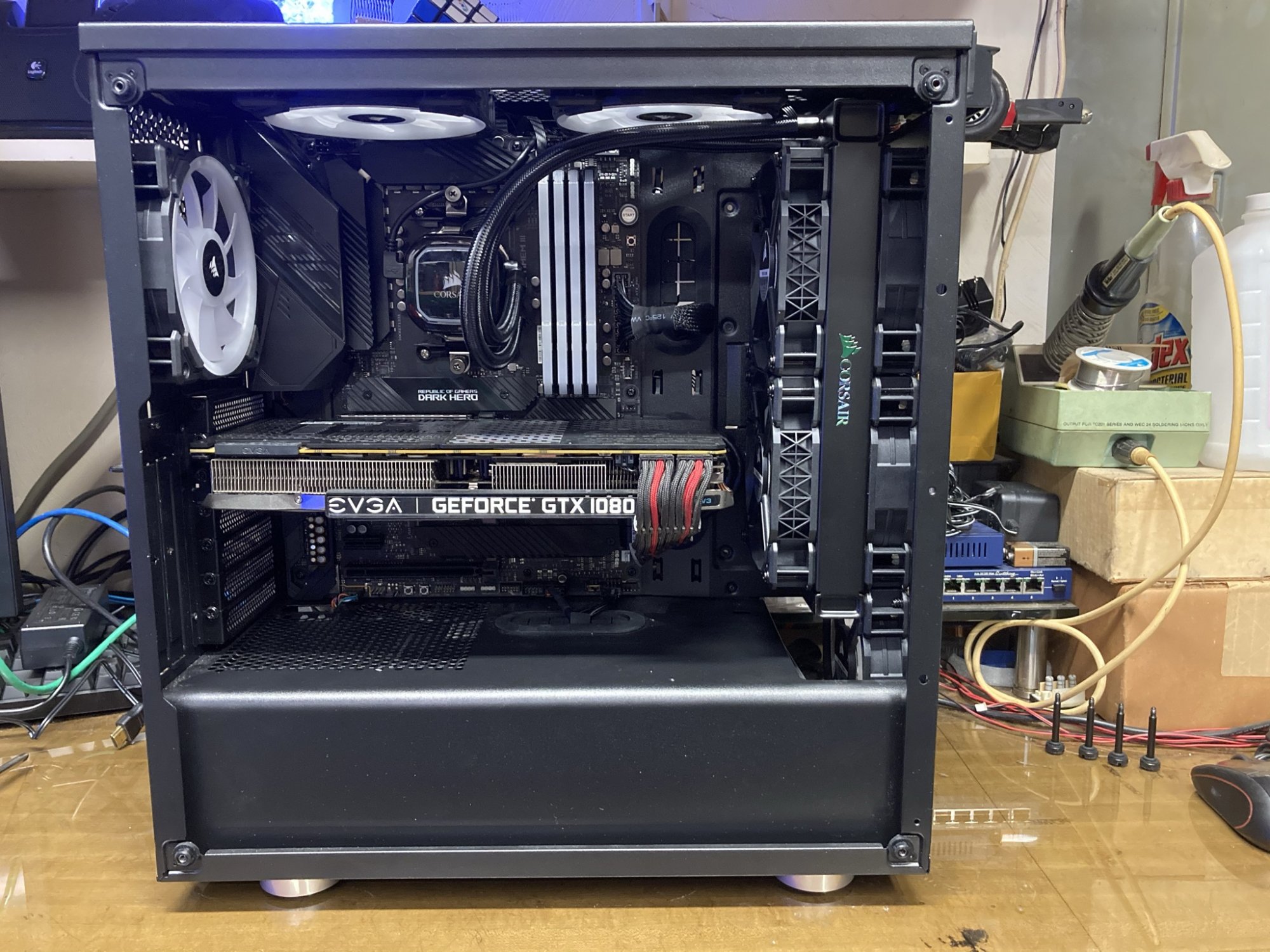

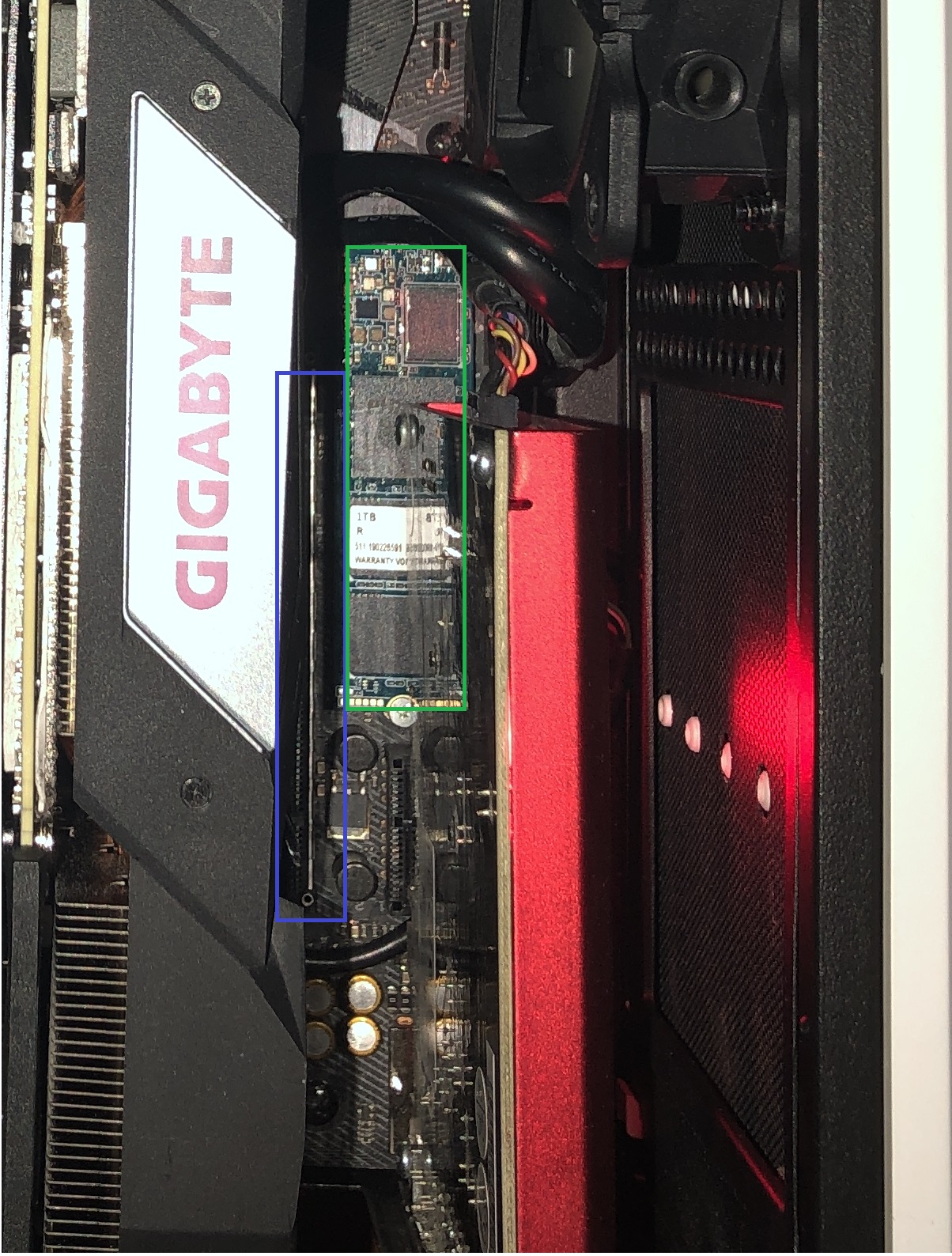

I should probably post this into a pc case section but here's the situation in my case:
The arrows point to air flows, and the red/green circle is the position of the SSD. I have a bit of separation in between it and the GPU, and it does have air directly on it. I also don't have a lid on the case because unfortunately I don't think the two outtakes I have could handle the amount of heat the GPU will pump into a MicroATX box.
I would like to move the GPU down a slot to the blue slot, and then move the Sound Blaster card up above it, but I can't. My other NVME SSD would be right under it and I'm kind of scared as to what this thing would do to it temperature wise. It's a cheap Inland 1TB.
Again I'll probably go ask in an appropriate section though. Thanks for all of the feedback here. I just really wish the "tempered glass window" crap would die off, because what I would have really preferred to be on the top of the case is a filtered slot for a large fan, not a freaking useless window. I don't sit there and masturbate to my PC enough to appreciate the intricacies of modern design, apparently.

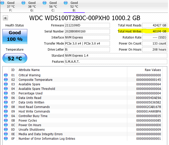

Kinda just had something similar happen. Purchased an open box WD SN550 Blue 1TB NVMe drive at a 25% discount, tested it on my USB to M.2 adapter to see what CrystalDisk had to say about it...
"Open box"
40TB written in the span of (at the time) 199 power on hours. Holy shit.
By comparison, my oldest NVMe drive has over 8000 power on hours and barely reached 20TB written.

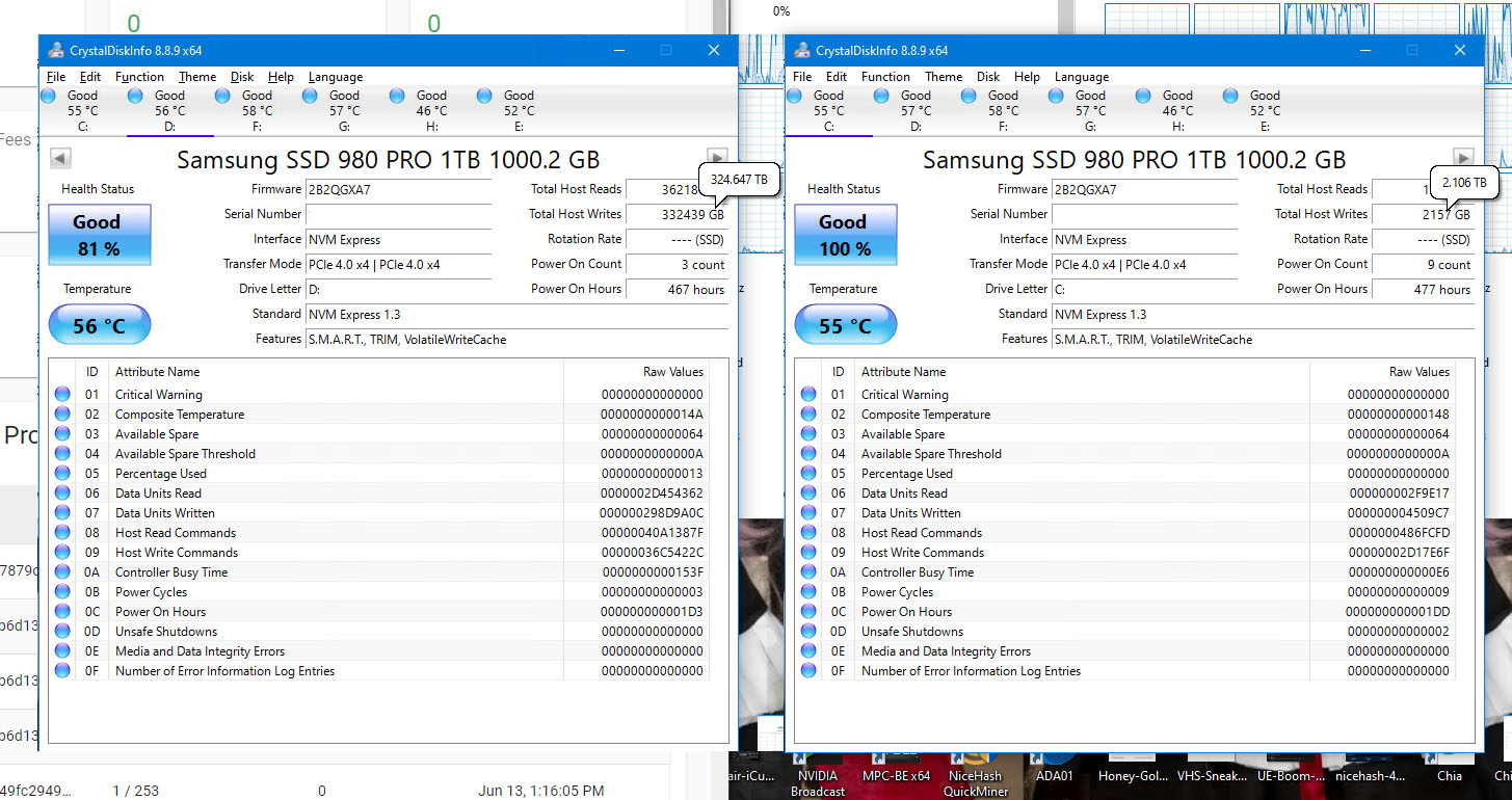

Chia chews through the SSD's, Chia drive on the left and my OS drive on the right
