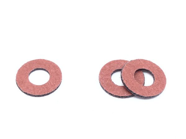

paper washers. cases used to come with them. could even just cut some squares of craft paper and jam the screw through...
I have been working on this fix for so long I am hesitant to claim it's fixed but after I used those black coated screws(only had 5 of 6 standoffs) It seems to be starting fine. My best guess is this short/ground might be the cause of the audio failure which wont be coming back. I may have to try the paper washer idea for the last standoff if I choose to use all 6 screws. Thank you everyone for the help here, this was my first project PC besides building my new PC 2 years back and it has sure been educational. A short was the last thing I thought it could be especially since the pc did run!.. I hope I won't have to post anymore here and that it will stay fixed but I'll have to continue the assembly now and see how far I can get...hopefully all the way!
I would use the washers that pendragon suggested, i like nylon but that will likely need longer screws. The painted screws will chew through that coating after enough vibration.
