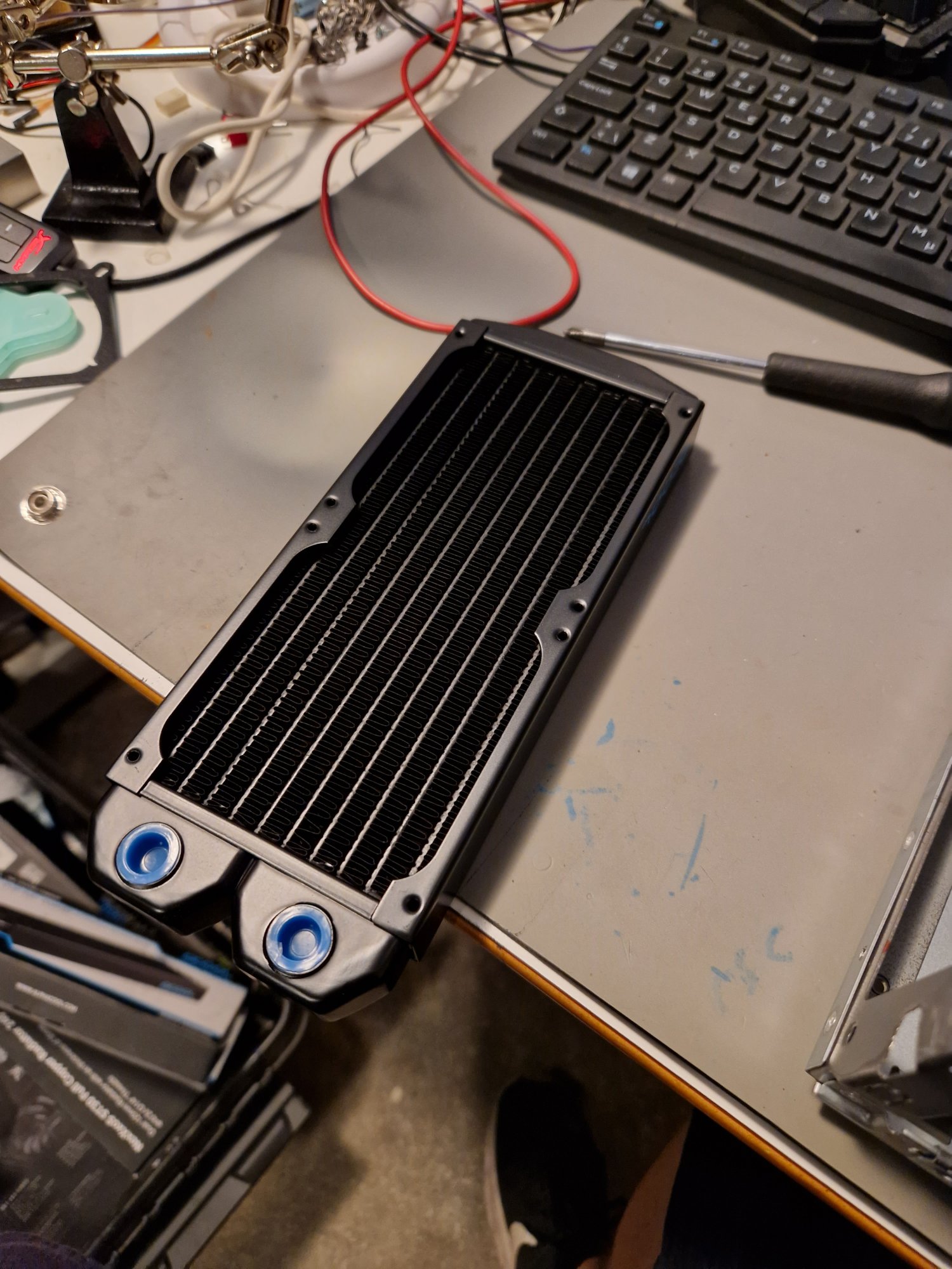

So running into severe fitting issues, so I did a rearrangement of everything:
So made the left side compartment for the radiators and made room for an extra 184x92mm radiator. Sadly I could not squeeze in one more 240mm rad.
And then the PSU will be besides the motherboard, I think it should be ok;

So gave up on the 92mm radiator and just went with 2x 240mm radiators.
So moved the PSU to the front and fits nicely after a bit of cutting:
And now there is room for a 240mm radiator on each side:
