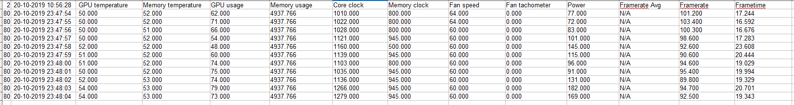

I wanted to see if it was my card boosting too high or something like that so I turned on AB logging. This is what things were like right before a crash:

I see nothing wrong really in that chart. GL with the board that is certainly my best guess at this point. Asus also generally is terrible for support but hopefully you get lucky.
