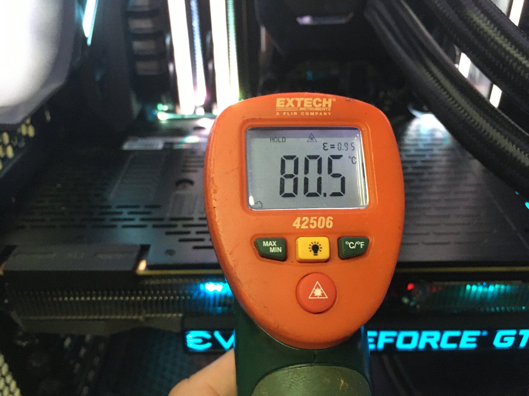

Running Furmark and the external temp on the GPU gets to this temp but it's still running and hasn't crashed yet after 10 minutes.

that seems fine to me....furmark doesn't always find instability that certain games might...but its a start
I guess I can rule out the GPU getting too hot and crashing the machine as it's been running over 30 minutes at 82C.

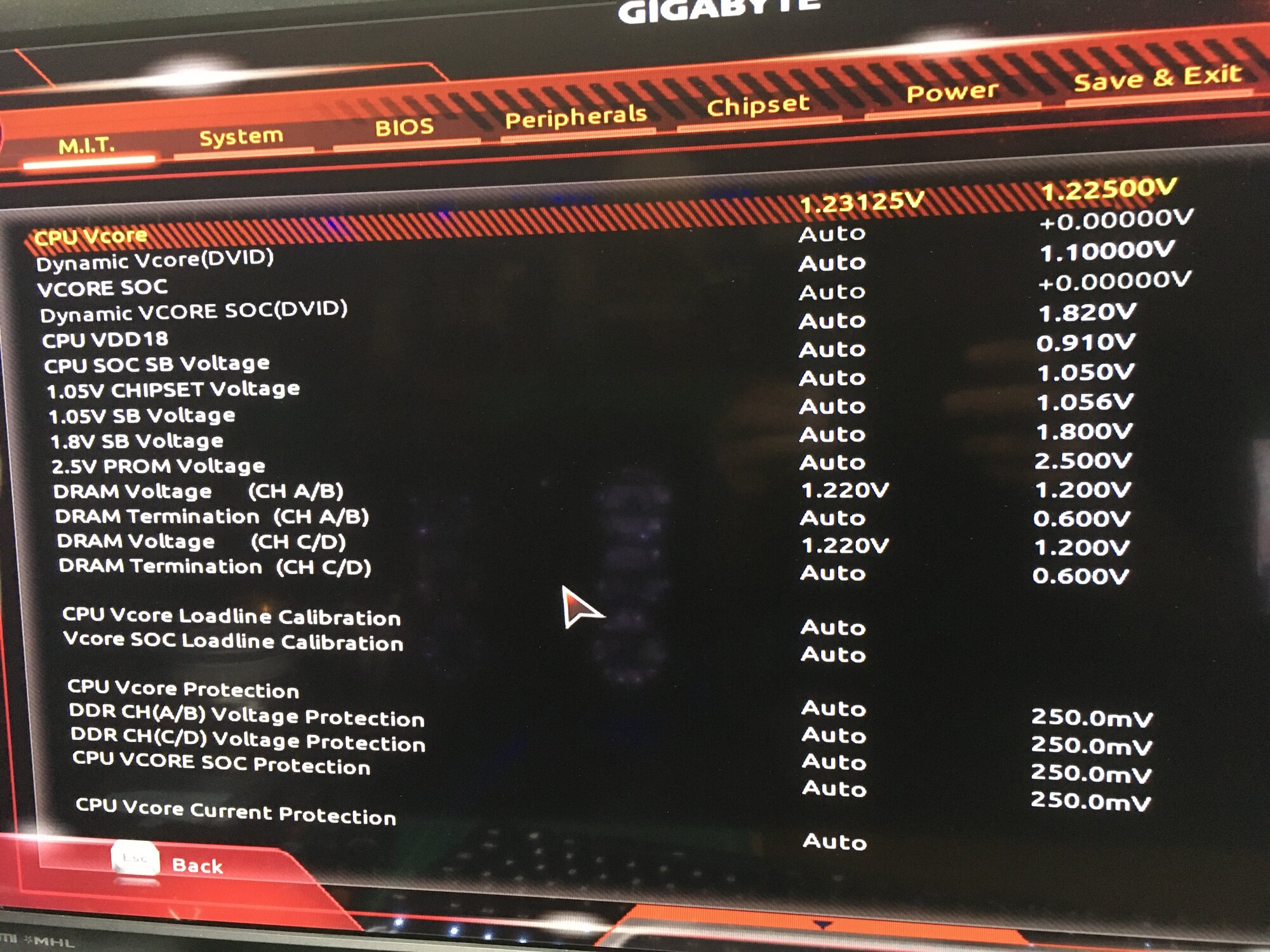

try bumping the ram and cpu voltages.
Stock was 1.20v on the CPU and Ram, and I upped it to 1.25 on them and no boot.
EDIT, 1.22 on ram and 1.23 on CPU causes windows to lock up on the logo when booting.
i think thats on the low side right?
even my cpu runs up to 1.5 volts (as needed) and ram at 1.35 just because

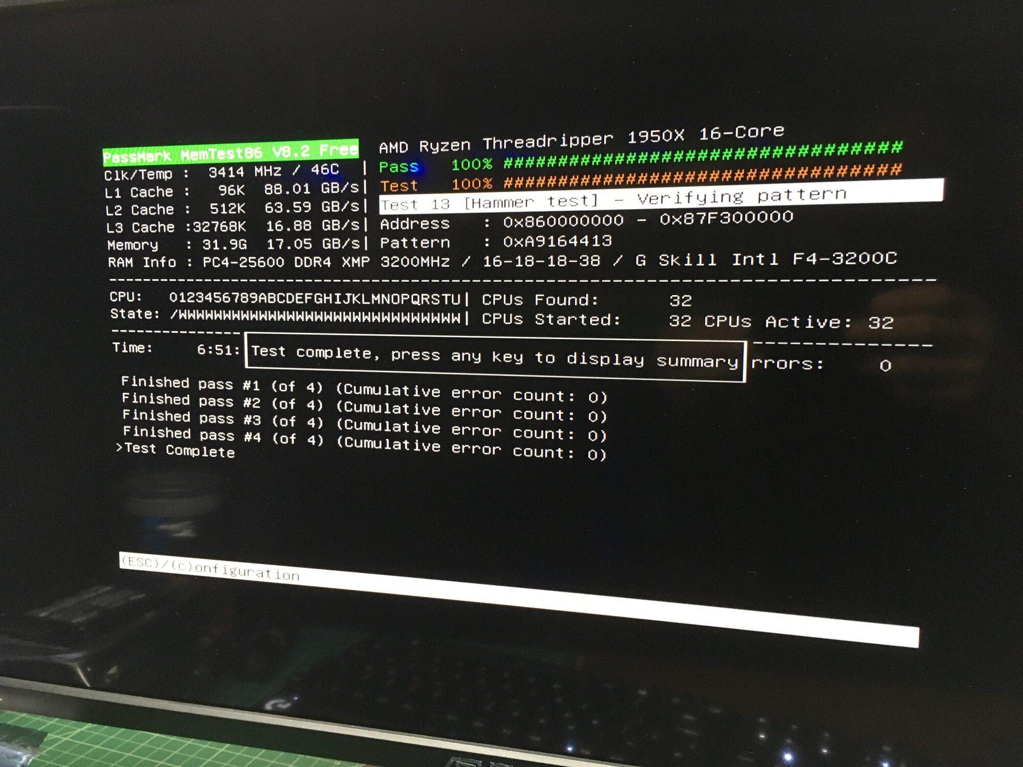

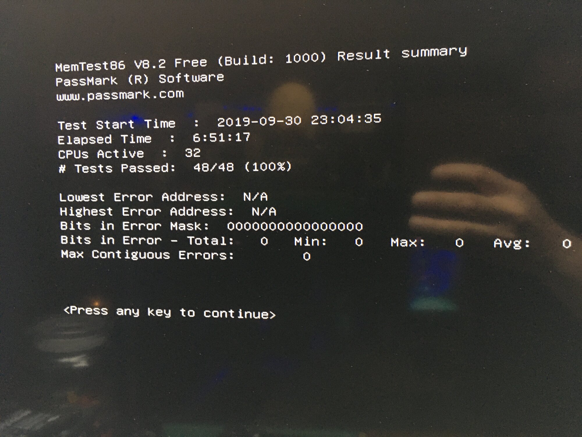

just for shits and giggles I ran Memtest and it passed everything, took over 6 hours though,

memory test proves absolutely nothing other than totally defective ram.....It will NEVER identify unstable ram thats randomly crashing....but hey keep up the good fight lol!:)
Pretty much 95% of bsod any of my setups ever had would not show anything from memory test, but would in fact be fixed with the correct ram settings....
