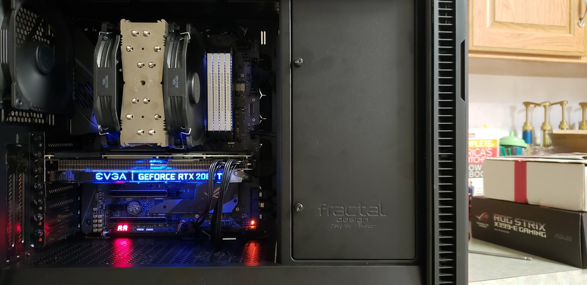

The ram are the Trident Z / F4-3600C18D-16GTZRX
Dont know if its just due to me only having 2 of 8 slots populated, but i don't think so, will be getting a set more in a few months when RAM price have tanked a little.
Ever since i build this PC i have looked thru the window in my Lian Li case at the meager 2 RAM blocks, and been very eager to go buy 2 more.
And if it wasent for my old GFX giving up 1 month after i build the machine and so forced me to go buy new GFX i think i would be on a quad system now.
But a Danish pension don't give room for the big arm movements, so i will have to chill a little, but then again if my ram ( currently at 1250 DKkr ) drop below 1000 i just got to do something.
