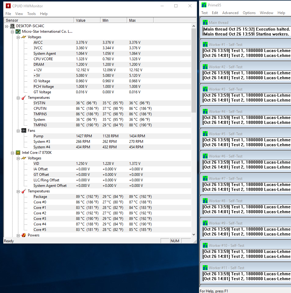

Had my old 4790k running at 4.6ghz all cores and highest temps got were 85C using a thermaltake frio 140. Stock my temps on my 8700k are 30C idle and 91C load running prime 95 using a corsair h60 water cooler. Trying to run all cores at 4.7ghz results in thermal throttling. Does the extra 2 cores really generate that much more heat?!

I returned the h60 and got the h90. Its a 140mm fan and bigger radiator. Using prime 95 i am getting 89c too stock. When i stress test using the intel xtu software im getting 72c. 13c lower with the h90. When i OC all cores to 4.7 hitting 100c and still getting throttling.

Didnt tweak the voltage left it on auto. I just wanted all cores to run at 4.7ghz

worse error *EVER*, one does not simply go to BIOS and set an overclock with autovoltage.
your issue it's that, when on auto the mobo will provide excessive amounts of voltages even at stock if certain features as Asus multicore enhancement are enabled (which are by default).. since Ivy Bridge I always, always recommend to utilize a -0.005v offset to voltage to avoid that kind of issues.

Yeah I personally see what multiplier is stable with a very small offset like you use. Then I'll start ramping it up as required. If you don't want to spend any time I guess auto voltage is useful along with whatever auto OCing features boards may use. Shouldn't be surprised though if you use those features for it to just throw tons of voltage at the CPU to keep it stable. As another note make sure you are not applying too much thermal compound. That can easily cause an increase of ~10C+

I haven't done any serious overclocking in a while...is 5mV really enough to make much of a difference?
Voltage has a huge influence on temps. Even that small of a chance will likely make a noticeable difference.

yes it does that difference because it work as a cap for the voltage, so it wont go wild or with crazy amounts that some motherboard provide, that's the huge difference it can make in temps, as most motherboard on auto can even apply a huge 0.200V over stock voltage while are under heavy stress like prime95 and such kind, applying a minimal negative offset also help to know the closest value to *Stock* voltage of every CPU

Ah! So it's not the 5mV per se, it's the effect that a manual adjustment has on capping the auto function of the bios.

Dont feel bad. I use a full custom loop with an EK block and big powerful pump. Guess what.... these things are friggin hot as hell. Nothing we can do about it except take the lid off and put a better compound down.
I will probably order a delid tool and whatever the forums recommend for a TIM solution. I am still debating whether or not I want to keep the I7. I have a killer Threadripper 16 core build as well and it games perfectly fine at high resolution. The intel is still faster at gaming overall though.

delid is the way to go.
I love my rockit 88 & 99 i have so far delidded 7 cpus this year with them most recently yesterday delided a brand new 7740x (x299 7700k) saw the biggest temp drop by far post delid on this one a whopping 30C drop in load temps! the 1151 cpus usually drop about 10-20C depending on how bad the original TIM job was from intel.
