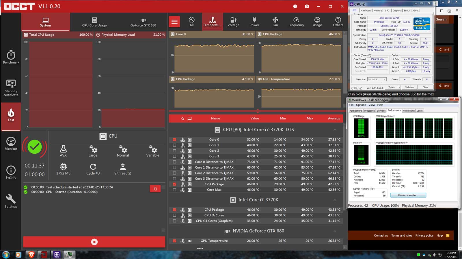

Is that cinibench R23 temps or what?
I just tried the Benchmark in that OCCT app and it immediately pegged my CPU package temp to 95C.

Also remember folks the default behavior of these is to run up to 95c and hold the clocks if possible. My 7700x will run right up there too on all core loads. All I’ve done to lessen this is go to enhanced PBO in bios (Asus x670e gene) and choose 85c for the max temperature target. I see 70s gaming with a U12S cooler same as before but now it only runs up to 85C under all core loads. The clockspeed loss is zero for games and lighter stuff and maybe 1-200MHz on a sustained all core load which I rarely do and even then 85C steady is fine indefinitely.

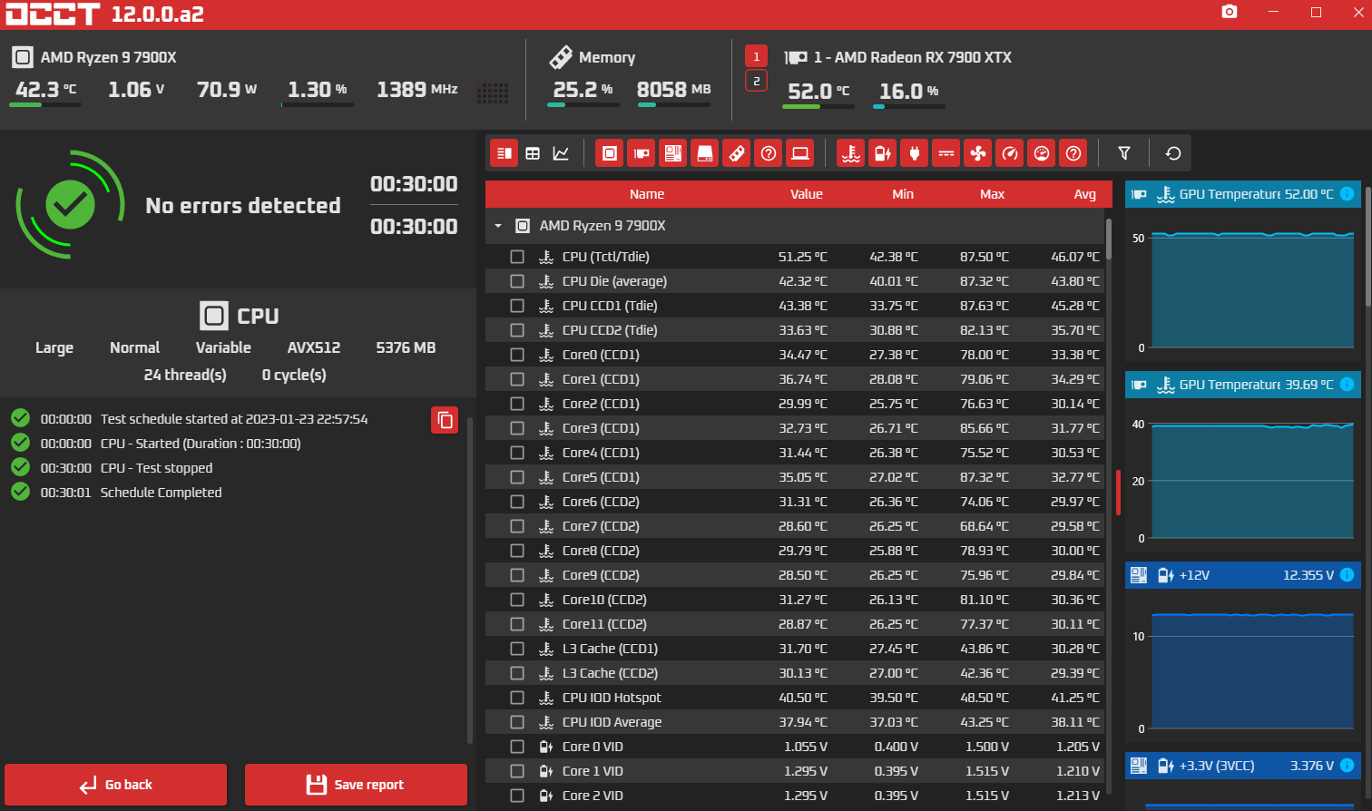

I have never used this, prime 95 back in the day. I will do the 5700X and see how it does.
THe hell with that app - my temps exceeded 90c and my computer crashed lol!
I took PBO off and this is all I got. I ran it later for 30 mins but the same temps/clock.

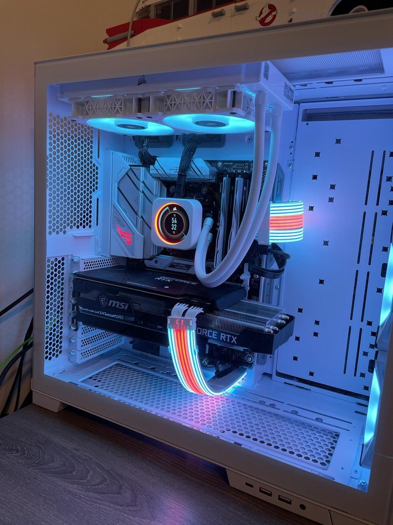

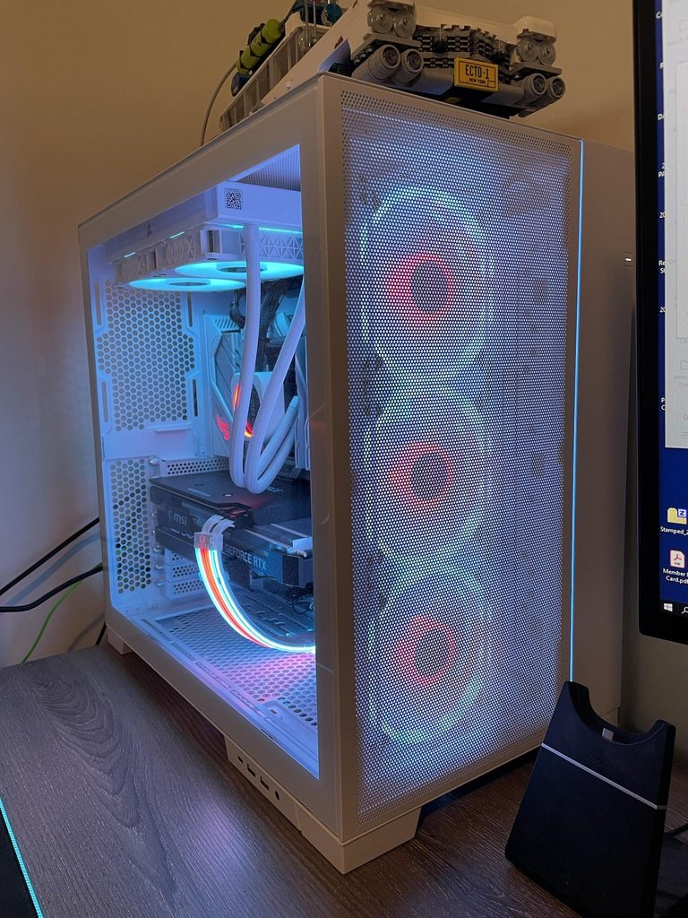

New to amd as well here.
7900X - out of the box voltage, with just the expo memory profile applied and a slightly different fan curve so the temp spikes don't trigger the fans every time I do something.
011 Dynamic Evo with 360mm Kraken, all lian li sp120 v2 fans. Rad is an exhaust setup.
Current idle temps with Ryzen Master show around 56-58c, under load with everything on ultra (sons of the forest) 1440p with a Taichi 7900 xtx I'm getting temps around 78-80c. I am using the stock thermal paste on the cooler and I will be swapping to thermal grizzly once I install my remaining M.2 storage.

idle temps seem a bit high. make sure you dont have any goofy apps running in the background keeping the cpu from settling down. build looks good though!
