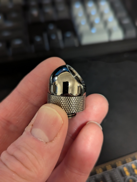

I did have a couple of XSPC rotary 45 and 90 degree bends of the style below develop slow drips on me through the rotary seal.
But as I said, it may have been my own fault. I had designed my own fan controller and built in a fan disconnect switch, which I accidentally ran with off during a gaming session (and didn't notice because of my headphones)
The coolant got up to about 50C at one point.
They were fine immediately after that but a few months later a couple of them developed slow drips, which luckily did not kill anything.
I don't know if my "hot coolant" incident caused the issue, or if it would have happened anyway, and they were just bad. No idea how heat sensitive those seals are to elevated temps. I mean 50C is high for a water loop, but is it high enough to destroy rubber seals? Maybe?
Anyway, that was a long time ago (2018) using parts bought even longer ago (2016) so it is unlikely a relevant data point at this point.

Regarding rotary angled fittings, I always assume they will fail at some point. I have had Bitspower, EKWB, XSPC and Swiftec rotary fittings fail and start leakin at some point, usually after a year or more of use, with the exception of the Swiftech which started leaking after a few weeks.
They usually just start seaping and can be very easy to miss with clear coolant.

I've only ever had those XSPC rotaries fail, but after they did I went to 100% bitspower, and I've never had a leak again. Many of the bitspower rotaries in current use are the same ones I bought as a remedy to the XSPC ones back in 2018, and they have been in 24/7 use ever since.
How hot do you let the coolant get in your loop? I wonder if that does have an impact after all.
Interesting.
I had several XSPC rotaries fail as well but haven't had any of my others leak. I went on a fittings extravaganza after the XSPC fiasco. EK, Byski, Barrow, Swiftech, Alphacool and Bitspower rotaries have all been gtg for me. Currently using all BP 45s, snakes and 90s with an old trusty XSPC ball valve (that's the only fitting I use by them now) in my main rig and all Swiftech rotaries in a backup rig.

those angled fittings are known to leak like that after a time. there's an o-ring in there that degrades. supposedly you can replace it. i tried when mine leaked, no luck! i just keep spares now.

Frankly it has probably been since before 2018 that I had one fail. The only rotaries that I have still in use are the EK quantum 90s and a couple of the flat rotaries, those have been rock solid. Once I switched back to soft tubing I just plan my loop so I do not need a rotary fitting unless it is absolutely necessary.
I started to get obsessive about coolant not getting much above 30c when I was using hard tubing and just kept that philosophy. General I have not had the coolant go much above 40c for years unless I was sitting there testing.
However back in ye olden days I have no doubt that I had coolant get up into the 50s so the extra pressure or doing tight bends after a rotary may have contributed to the rotary failures.
Been using bitspower for angled and xspc for straight for as long as I can remember. I change the rubber o-rings every once in a long while during a complete overhaul of new tubes when they get cloudy, cleaning blocks for good measure , and new o-rings for preventative maintenance. Never had a leak.
My Bitspower and Monsoon rotaries haven't leaked in 12+ years.
I've stopped using 90 degree fittings altogether now and I am able to turn down the pwm on my d5 as a result.
This thread also reminds me to order another set of bitspower 45s to have just in case of an emergency because I have used all of them. Almost every single fitting is a bitspower 45 rotary lol.
Keeping in mind that even though I've replaced all the outer O-rings, the inner o-rings are not serviceable so at a certain point if one leaks it is recommended to replace it instead of trying to pry it open and service it.
I wish I didn't care and just use straight fittings but the 45s just eliminate pretty much all of the spaghetti look to the tubing.

Update- Pics of the garbage XSPC rotaries AND I managed to break a BP rotary. Yep, gotta love that press fit goodness. 3hrs later I've tested every 45 and 90 in the loop to the best of my satisfaction. No loose ones left in there by jimminy!!!
