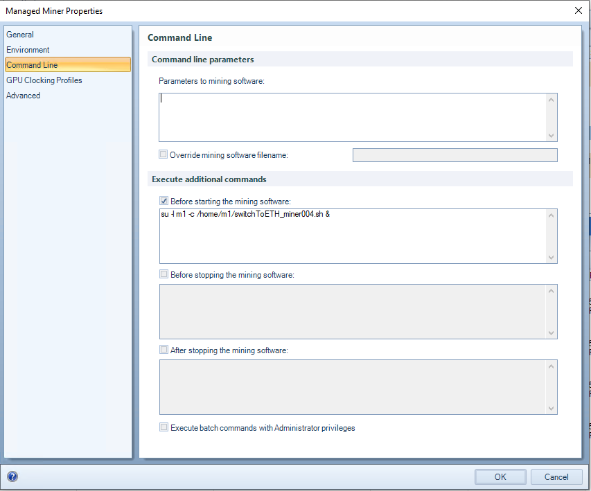

For each AMD rig, I call a script when launching the miner as follows:
And the script itself looks like this:
