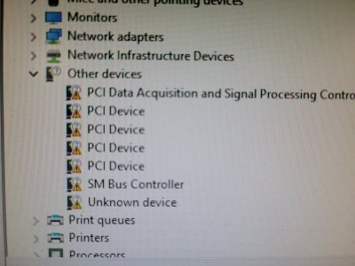

Unsure if it has to deal with this from Device Manager? Only PCI thing I have is my GPU

Did you install the chipset drivers? Right click, install driver on all of those yellow marks. You missed some drivers on install. Overclocked? Remove it. CPU temps? Memtest?
They don't auto find drivers and no clue what device they are. I installed all drivers directly from asus
Remove the main board from chassis and build on a piece of cardboard on the desktop. See if chipset drivers install properly then. Gets you closer to RMA if necessary as well when diagnosis is complete and sometimes exposes the fault in the process.
I would find your missing drivers but it wouldn't cause all those issues. is the ram running XMP or default? CRC and random errors sometimes are stupid things, or memory
