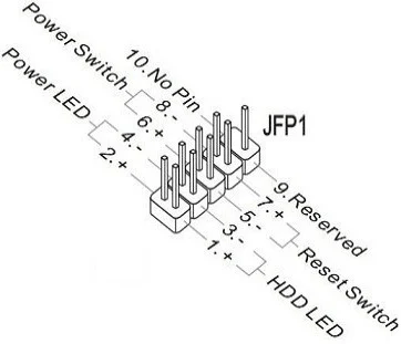

Also onboard this band wagon. Since 2+ M.2 ports on motherboards are now more or less ubiquitous, cutting out 2.5" SSDs has been a dream for cable management. If we cut down on PCI-E cable bulk, then the only thing left that mildly annoys me with DIY builds are the case's front panel jumpers:
Been doing DIY builds for 20+ years now and I'm still amazed that there's been virtually zero innovation here. I've seen some boards ship with an extension that makes the process a bit more convenient, but I'd be grateful if I never have to plug in another set of jumper cables in my life.
Aye, I'd be 100% on board with that. Everything else about system assembly I could almost do with my eyes closed. Almost every build I've done has posted on first try. On my X670E Carbon board, they even had these twist locks for the M2's, which was a great innovation since god I hate those tiny screws. But The pinout on the jumpers? Have to dig out the manual every single time...
And break the compatibility that standard has been providing for 20+ years.
Technology innovation has a way of doing that. However, it would be trivial to include something like this with case and motherboards accessories during the transition period. I know because some already do this.
I'm sure there were plenty of folks here who were upset when we moved off of serial, parallel, IDE, AGP, etc. in the name of breaking compatibility. Will the the two people still using their 20 year old steel beige case even care? The front panel jumpers are infinitely less complicated than all of the above, "backwards compatibility" is a very weak excuse not to innovate there.
