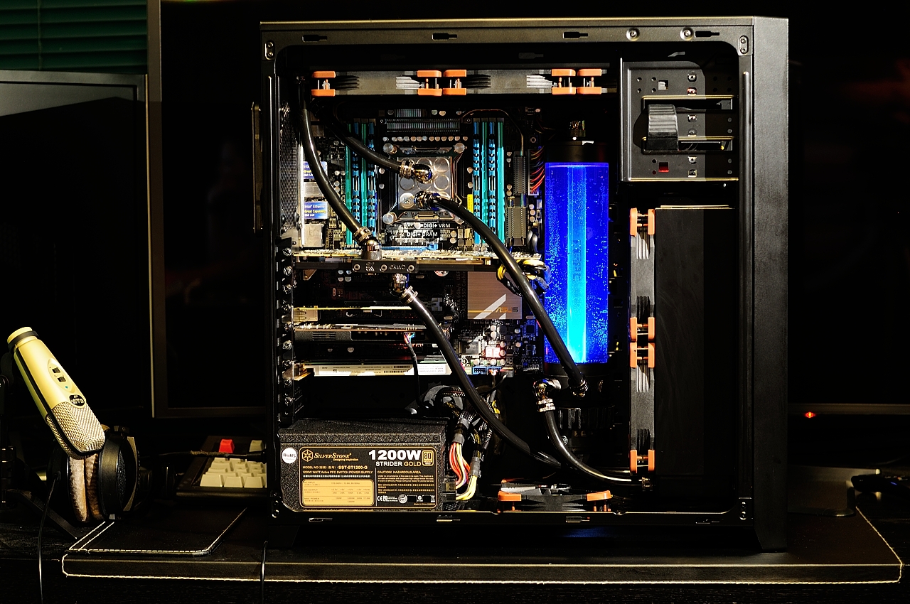

Here is what mine looks like all installed:
