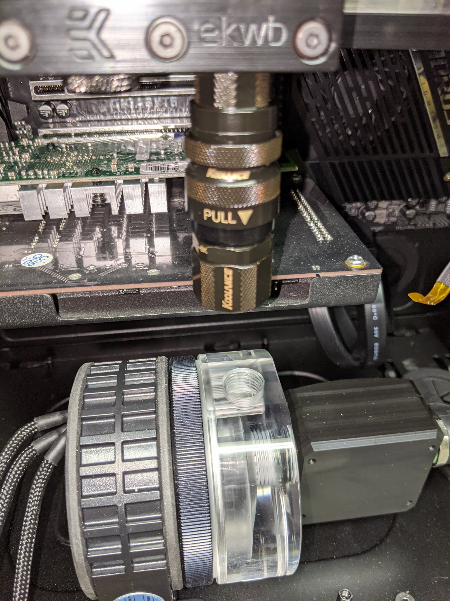

I don't think I'm going to be able to make the QDC between the pump and the GPU fit :(
I bought the QDC's with the G1/4 attachments on the back because nowhere had three of the compression fitting ones in stock, and I'm still not clear if they are for hard tube or soft tube, so I had to use a female to female adapter and attach my compression fitting for a very short run of tube.
I wonder if I get one of the QDC's with the built in 3/8" ID 1/2" OD if the overall length will be shorter....

Just got the version with the integrated compression fitting.
Looks like it saves me about an inch, which should make this work!
I hope this is the last part forcing me to stop and wait for shipping... Again....

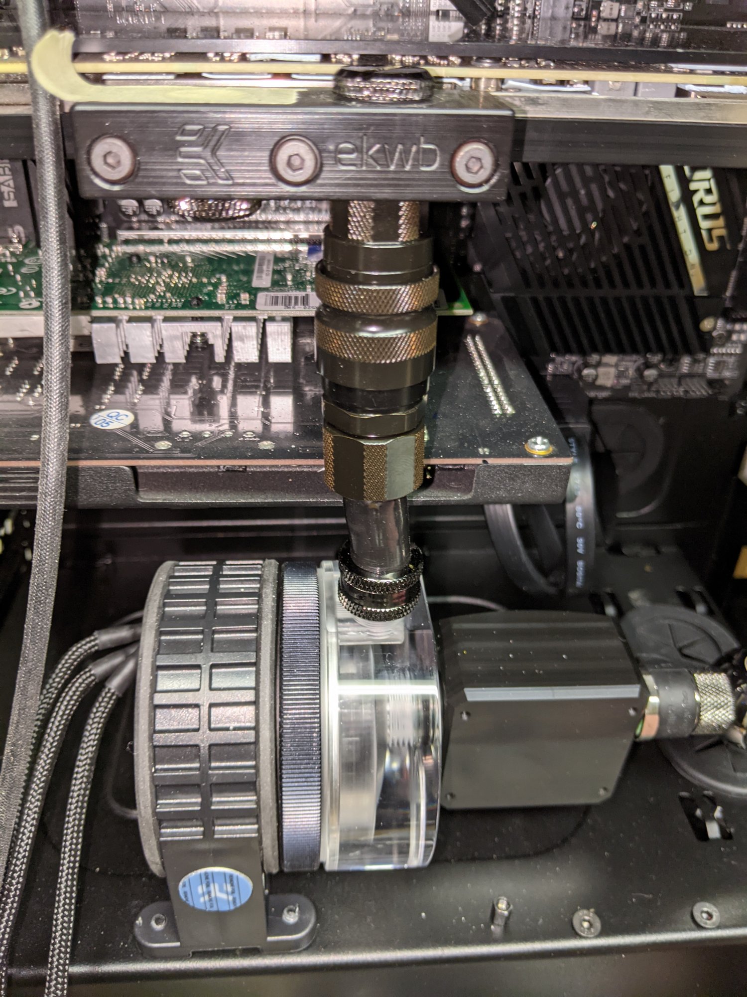

Sure that is going to work once you get the fitting and tubing in there? I don't think you are going to have enough play to release the fitting....or put it in place. Am I missing something?
Experience has taught me that I am sure of nothing. To the naked eye it looks like it will just squeak by, but it depends on how compressibe the tube is once installed.
Going to do a test fit in a bit, once I find my tube cutter...

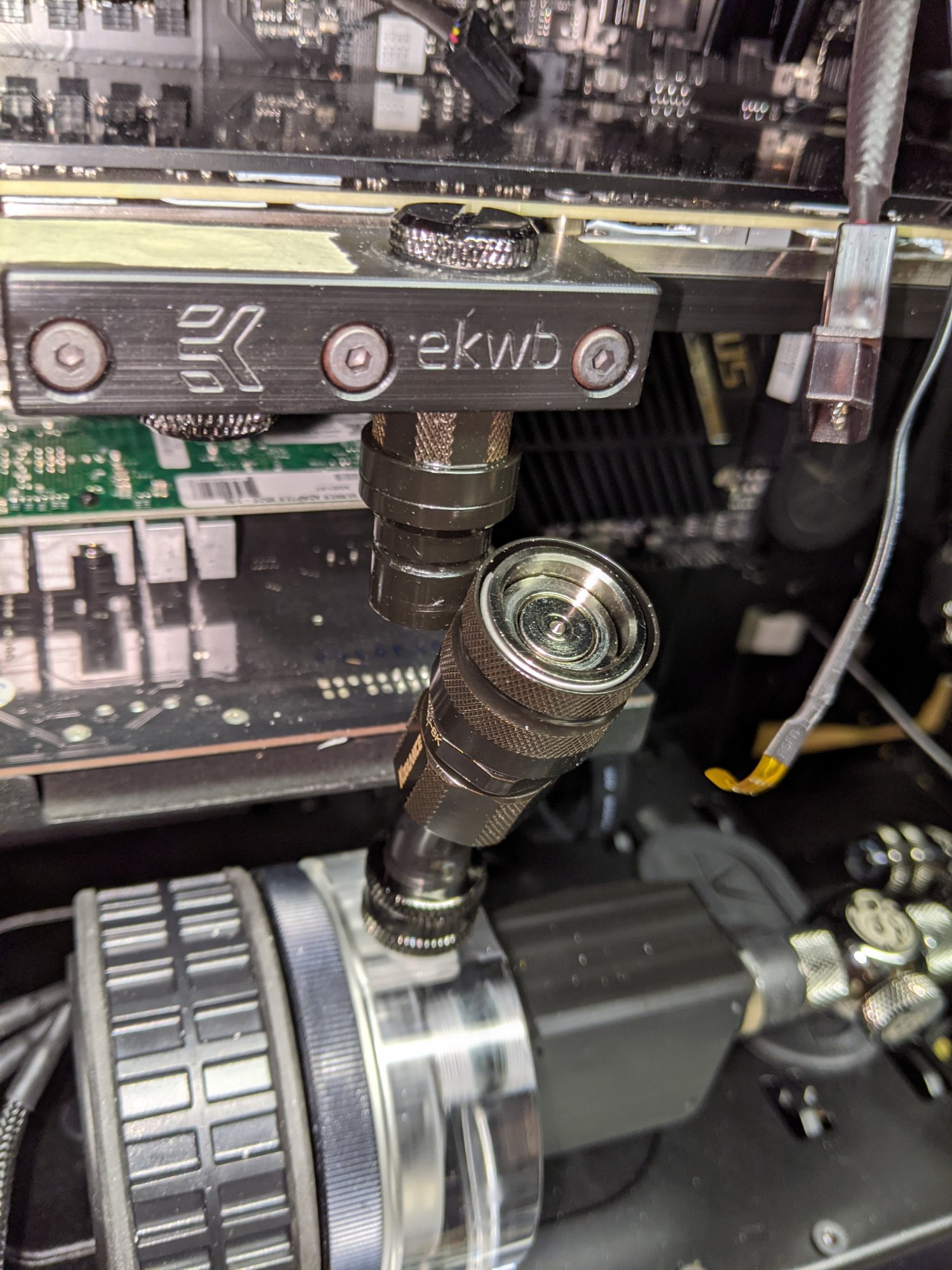

It is close, but it works.
Takes a bit of finagling, but if I loosen the GPU screws and tilt it slightly up I am able to connect and disconnect it with ease!
Wish I had mounted that pump straighter though. Looks like it is about 3mm to far right.
I did measure twice (actually several times) before cutting, so I don't know what the hell happens.
It will work. Not as pretty as I had hoped, but I've always been more about performance than looks!

Omg, that defeats the point of a QDC, there's nothing quick or fast about that. And really... since you're doing it that way and the gpu bracket is screwed in you should have just used a SLI link. Once the loop is drained, the gpu can be easily released from the SLI link.
Hell of a lot faster than draining and refilling.
No doubt about that. My comment is more about the positioning of your pump which results in the position of the qdc. That really detracts from the ease of using a QDC. Ideally the pump should be on the side, not directly under the port. That way you can use a length of hose like in the example below.

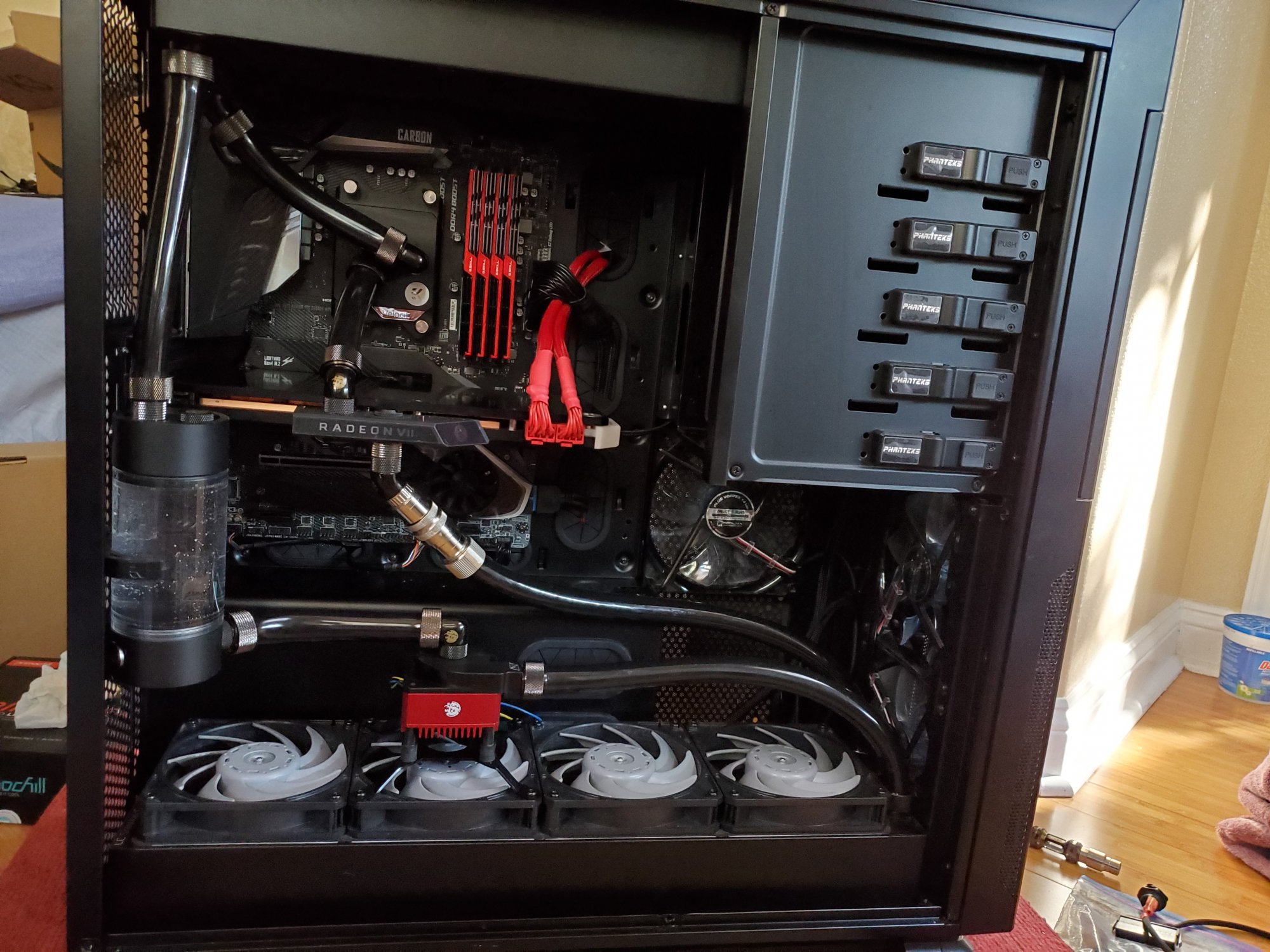

In the above pic you'll see I don't use a QDC above the gpu. It's my kids case so I don't go changing gpus in it often, then again I haven't changed gpus in my own loop in four years. I suppose if I had to I could swap the res inlet and gpu outlet but that doesn't matter.
I know this is preaching to the choir at this point, but I love the QD3 connectors...so precise, and I just redid my hard tube system with ZMT tubing and the QD3s with 10/16 compression ends so I can pull my GPU and CPU blocks for easy parts swapping. I do tend to upgrade at least one component or fiddle with something at least once a year.
