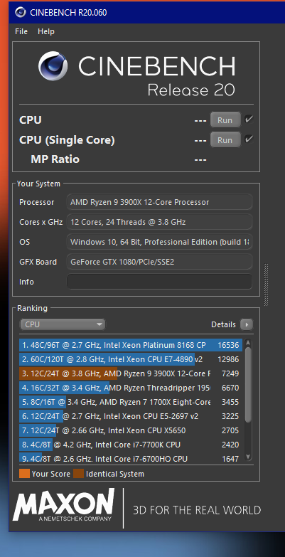

Running the same test all cores running at 3800GHZ using 113 watts, 65-66c for temps according to AMD Ryzen Master. At 3.95ghz and 155-160 watts that seems very high, we are talking a difference of 150mhz between our CPU speeds and a extra 42-47 watts to achieve it.
I also ran Cinebench for 15min and all cores remained at 4000GHZ and the total watts used was still 113w, while heat stayed at 65-66c. Again this according to Ryzen Master, with HWinfo running alongside.

My 3900X would never hold that sort of boost in Cinebench R20 with stock power restrictions, temperature didn't matter at that point as I was bumping TDP below 4 GHz.
Ive run it numerous times and averages 4025-4075ghz all cores with latest score of 7249, in the beginning of the test boosting to 4100ghz and by the end at 4025-4050ghz, temps are typically 65-66c. My ambient temps are around 63F.
I believe you. You have a more efficient 3900X than mine. My 3950X is also not a great clocker as it scores lower and boosts lower in CB R20 than most others I've seen. The silicon lottery is alive and well. You got a nice one.
This run goes up to 71C. As you can see it hits 4.275Ghz all core. I get 517 single core at 4.6Ghz. This is obviously not with a Wraith Prism but show what the processor can do. I use an AIO but I am pretty sure one of the bigger Air Coolers could keep the temp in the low 70C range as well.
