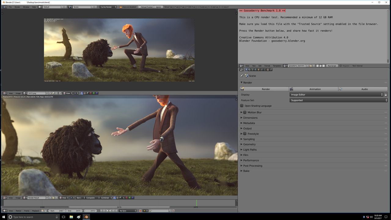

Well, that did not take long. ;)
22min 37.19sec
Not bad! I can't wait to install mine and attempt to beat you!
YES! I am sure there are some of you that can best me. I am making one last run attempt now. But I got a yard party starting here in a bit.
I just got 23mins 50 seconds with all 1950X cores @ 3.7Ghz 64oC 1.16V on a Kraken X62 (with a number of apps open and a youtube video playing). Have to say, super impressed by this CPU. Rendering temps are very low with unreal speed. I'll try again soon with less 'mess' going on in the background :D
tried running it for shits and googles on my 1600 but peak memory usage easily exceeded 16GB even though blender was showing a peak usage of 6.8GB. :(

dang TR is fast, my quad socket is only a few minutes faster. looks like a good chunk of the runtime on faster systems is setup though, there were several minutes of single-threaded kernel initialization and BVH computation
Time to hook up the waterblock to a larger radiator and/or some 3000+ rpm fans and shoot for 4.1GHz?

22:47 on mine (1950x @ 4GHz (1.325v)), but I have a lot of additional processes in the background so that might be my issue. Regardless, it's fast.
54:39:33 on my i7-3930k at 4.4GHz.
32GB DDR3-2400 memory.
I walked away and the screensaver tried to come on, I'll retry with some other options.
This used the most memory of anything I've ever ran; 18.4GB used total.

You can't adjust individual core frequency, as the entire chip runs at a set frequency from the mainboard.
The sliders you see are showing whole chip frequency for the number of loaded cores, ie if only one core is loaded, run chip at X frequency, if only two cores are loaded, run chip at Y frequency etc...

I've got some bottlenecks for this bench. Takes 4-5 minutes to initialize. Think I need a clean install.
I did get it running stable at 4 GHz/1.29v, load temps ~70c with the EK block.

I tried running it last night. It crashed after a minute and a half every time I tried to run it.
I had the 12g of memory and am running a Xeon 5670 on Win7.
It carries with it a load. One of the reasons I ran this was one of the "Industry Analysts" posted his Threadripper running stable at 4GHz across all cores with proof of such in the form of a Cinebench score. Of course we all know that is not any sort of measure of system stability. I mentioned that do him.
He went as far as to suggest that it in fact was "stable." We all know that is most likely bullshit, but I did ask him to see if he did in fact get the unicorn cpu. I would love to see it.
Thanks, Kyle. I did get it to do the full IBT test at 4.4ghz earlier, so I thought it was stable enough to do this new one. I tried 4.3 after crashing a bunch at 4.4 and it still crashed. I will try it tonight at stock un-OCed speed to see if it crashes. (It is an older 5760 pulled from a server that I bought a few months ago to replace my 920 that was running at 4.3 since I bought it long ago.) It runs hotter at 4.4, so I mostly use it at 4.3 unless playing with benchmarks.
