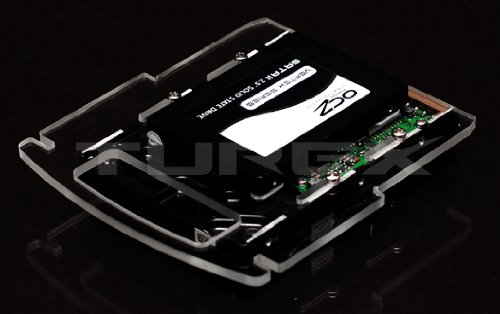

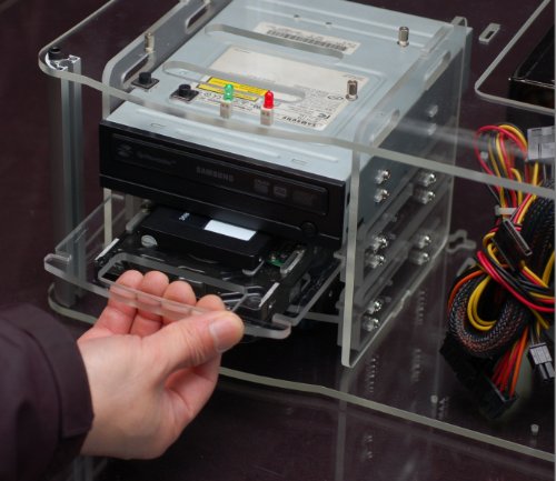

Sure! Placing the mounting bracket in between a fan and the radiator would be okay. There are already people doing that tin regular case installs. If the bracket metal thickness turn out to be too much for the Corsair included screws than I will just buy another set the length needed. Or cut down a set of longer ones to fit..
Here is the drive sled idea in pictures from another design. The optical drive is still fixed. The hard drives are able to be moved easily..
Got it. Building that drive rail system would be easy.
*EDIT: Does anybody know of a reputable supplier of the plastic hard drive sled thingies used in a lot of cases these days? *
