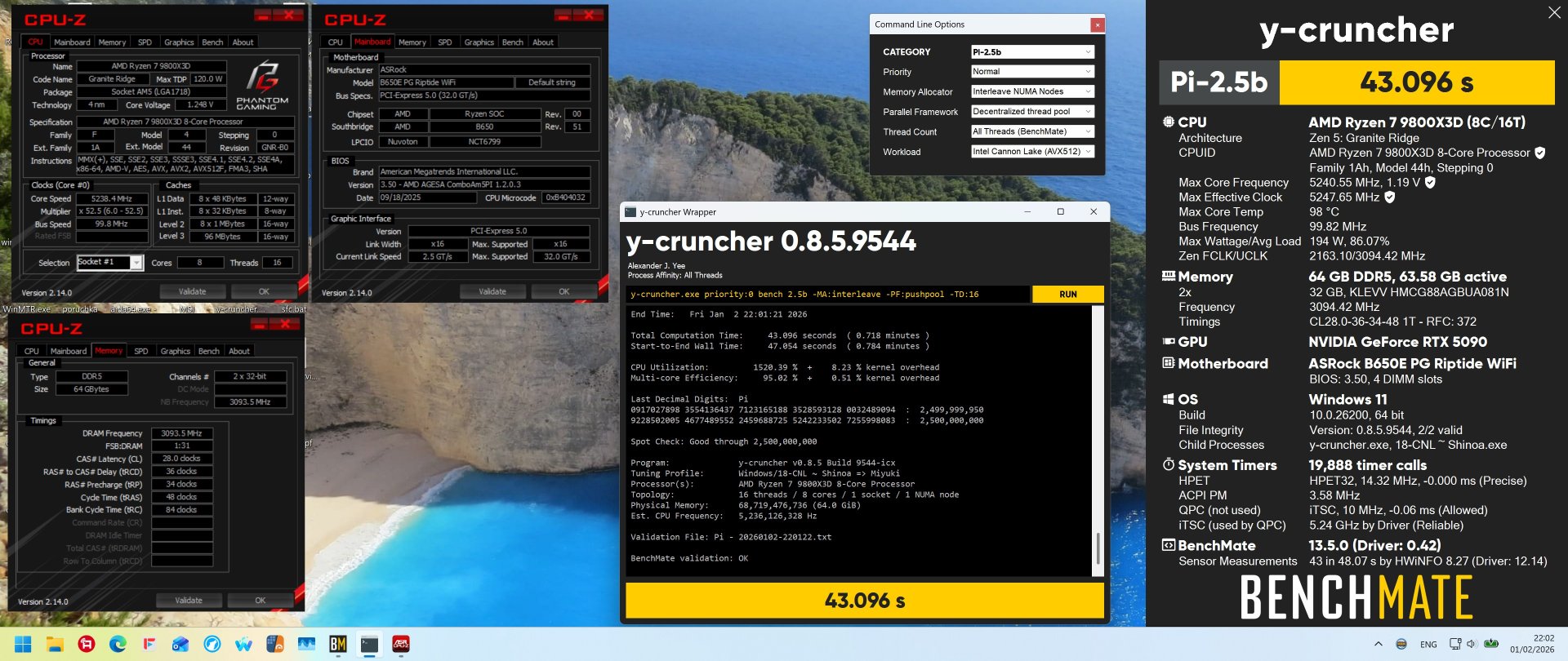

So what temperatures are you guys seeing on your 9800 x 3ds?The problem is not the safe voltages, but that in manual mode OC Ryzen stops maintaining temperature.
So yes, we can set the 9800x3D to manual mode at 5600 MHz, but we have to very carefully manage what software we are going to run, because if we run something very heavy, it will shut down immediately.
Normally PBO manages the CPU frequency, but manual OC will just run it at 5600 MHz.
So yeah, somehow we can play games with manual OC and it's really better because we gain some ns that normally PBO uses to manage the frequency and that's a plus for gaming, but we can't control the temperature and that's a risk of CPU overheating.
Here's a clear picture regarding that, here the processor is only at 5250MHz but in manual OC, and you can see that it easily hit 98C (194w).
Because that's why I asked how this "5.6GHz" is achieved, because with an expensive motherboard that has a clock generator that can increase the FCLK of just the CPU, then the PBO can reach a really high frequency where it will also maintain its temperature.
So AMD are playing a bit of a tricky game here with this and just selling some "frequency numbers" because they control it via AGESA. Of course, they combine this with good binned chips.
