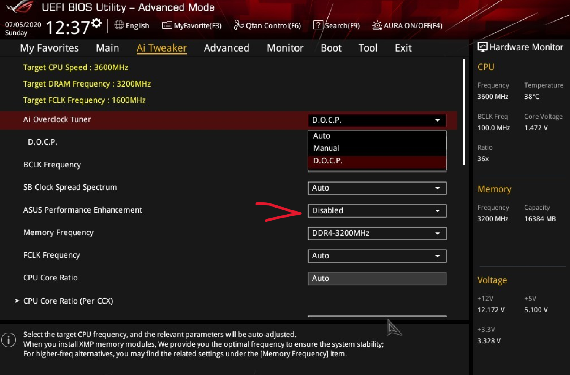

So I just reset the BIOS to factory defaults and I'm still getting the same high temps. I noticed that when I increase the load on the CPU, the CPU voltage jumps up to 1.28 according to Ryzen Maser. The increase in voltage raises the CPU temp. I'm wondering if there's some sort of setting for the ASUS Strix B550-F motherboard that pumps excess voltage into the CPU which causes the higher temps? I downloaded HWiNFO 64 but most of it is totally foreign to me since I'm not into overclocking.
its an asus board, it probably has some type of cpu "enhancement" on by default.

voltage is high and you probably need to set the pump to max however your controlling it, and probably adjust your fan curve.
Thanks Pendragon1, I went into the BIOS and confirmed that is turned off. My ASUS Strix B550-F has that exact same setting on the Ai Tweaker tab that was in your screenshot.
ok. then lower the voltage a bit. running the curve optimizer might do it too, but manually crank up you fans and pump first.
