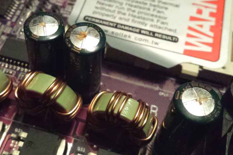

Looks like you got a few bad caps on that board ;)
I count at least 5
Yep ... good catch. Damn capacitor plague. Did not realize they would go bad from sitting as well. A shame since this was final revision of the board that accepted T.bred CPUs. Oh well. One more thing for the electronics recycling bin at the landfill.
Whoa now, it's not THAT hard to recap it!
That is what I was thinking. Soltek was a very good company. They sent out free capacitor replacement sets to any customer who requested, whether you had a bad board or not. Will see if I can find the kit that I received way back then.
^^ is a prime opportunity to play with my wick & sucker o_O
[edit] - seven bulging caps on this board by the way

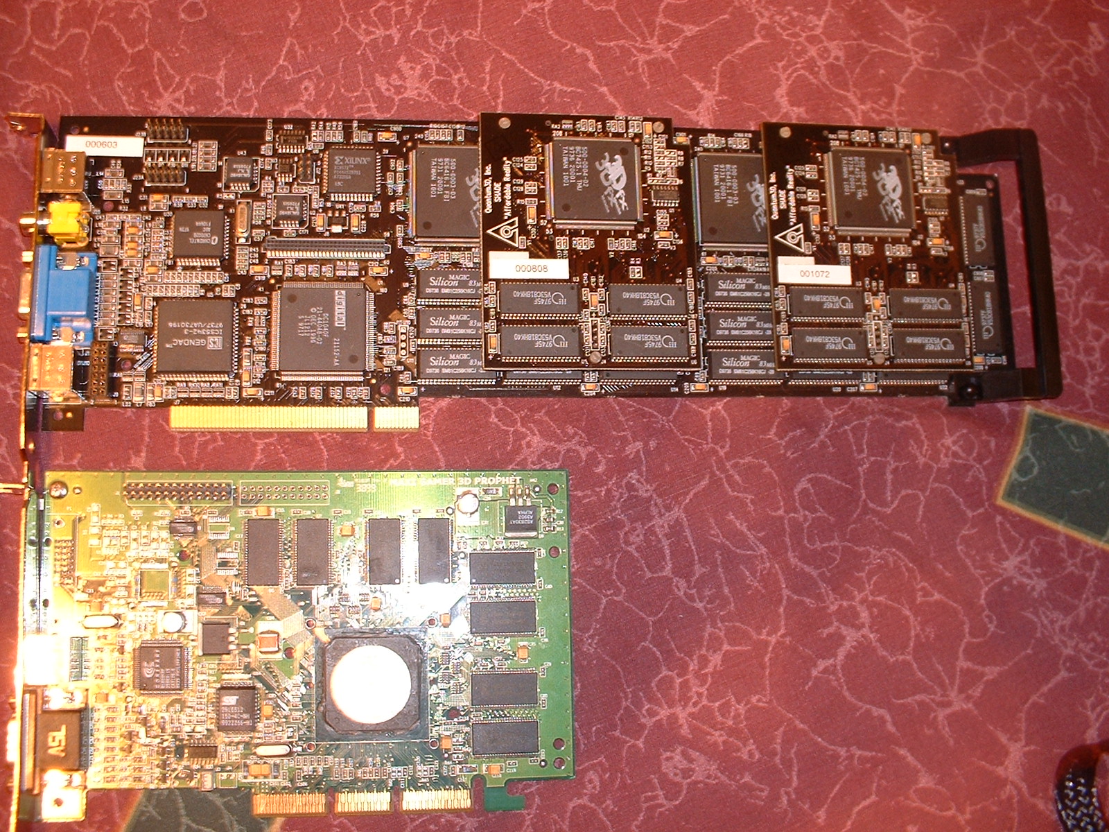

I have a few 3Dfx cards myself, but I was always more interested in the unique ones from Quantum3D. They made ones from Arcade Cabinets to Military Simulators.
I had their Obsidian 100SB which was a Dual Voodoo 1 card (they kinda pioneered multiple cards in one, as far as I'm concerned), but sold that over a decade ago for like three times what I bought it for (paid like $45, bought/sold early 2000s). You couldn't get a sense of the length there, and so here it is next to a GeForce SDR (aka GF1)
I believe I still have an Obsidian 200SB somewhere Dual Voodoo 2 card, which is basically the same as the Obsidian X-24 consumer version. It was an arcade card.
Then my pride and joys...
A very-very-very rare "Sensor Post Processor" card which has a Voodoo 3 at it's heart but DVI output, and was physically connected via header pins and basically did Shader effects for these next two... (It's attached to one of them in that picture, sorry for the bad quality it was a ~2001 3MP camera lol)
Then I have two of the only very-very rare AAlchemy 8132 with 8x VSA-100 (V5 chips) and 32MB each. These pics are of the 8164 with 64MB/each but otherwise same cards, I just don't have any of mine handy...
Front, Back, Crazy power adapter (Yes, that sticker is legit, and Q3D engineers had a great sense of humor!), SPP+8132+Power
Unfortunately that 8132 required a unique PSU which put out 2.5-2.7V to feed these cards, so I've never actually gotten to use them. I do have drivers though, and I know the SPP works :D I actually came up with a way and shared it with others long ago (a 30-40A Adjustable Solid State Buck Converter), which proved to work so I'm glad it's not hopeless :p
[/thread hijack]

Yup just cracked open the old rig and shined a flash light on the board and low and behold 3 blown leaked caps out of 12 of the large important ones..
So ive got a big project on my hands now.
Found a bag of 50x 2200uf 10v that will work on amazon for like $4.50 free prime shipping ;) sweet.
Sounds like we're in the same boat. Needed several 2200uf. That is a good price. What caps are they? I went with Rubycon ZLJ series. Spendy, but figured what the hell.
Uxcell brand? Wont be used much. Need 12 and not willing to blow 3-5 ea on them as ive done in the past.
Rubycon caps on the way. Found caps on other boards bulging yet not burst yet. Including a few on the Abit kr7a that I am using in the Win98 rig right now. Found it interesting that all the bad caps are 6.3v, two different brands, three different 'F' values.
If I recall correctly, part of the cause for the entire bad cap plague was some improper electrolyte formula got used in bulk by several manufacturers of components. There was also a plague of counterfiet caps as well i seem to recall.
Was just curious. I paid 78 cents each in a lot of 10 which did not seem too bad for these particular caps.
Yes indeed. They are calling it the "Capacitor Plague" now. Wonder how many millions of dollars were wasted on dead hardware across the globe. Think it was even attributed to communication satellite failures.
>> https://en.wikipedia.org/wiki/Capacitor_plague
[edit] - got to looking at my Abit kr7a boards. One has Teapo (Taiwan) caps that are on edge of failing. The other has Rubycon (Japan) in the same locations that all look great. Both are "version 1.0" but the logo is at different spots. Guess they were made on different production lines and/or Abit decided to switch up cap suppliers at some point.
Back to the Voodoo ... runs great. Stuck it in my XP box for now and tried out five random drivers from that link posted above. Ran three tests each in 1024x768. 16 bit color & texture were 3dMark default settings. Best scores with Dozer v1.1. All other drivers were 500-700 points lower. That includes the XP native driver, and official 3dfx.
