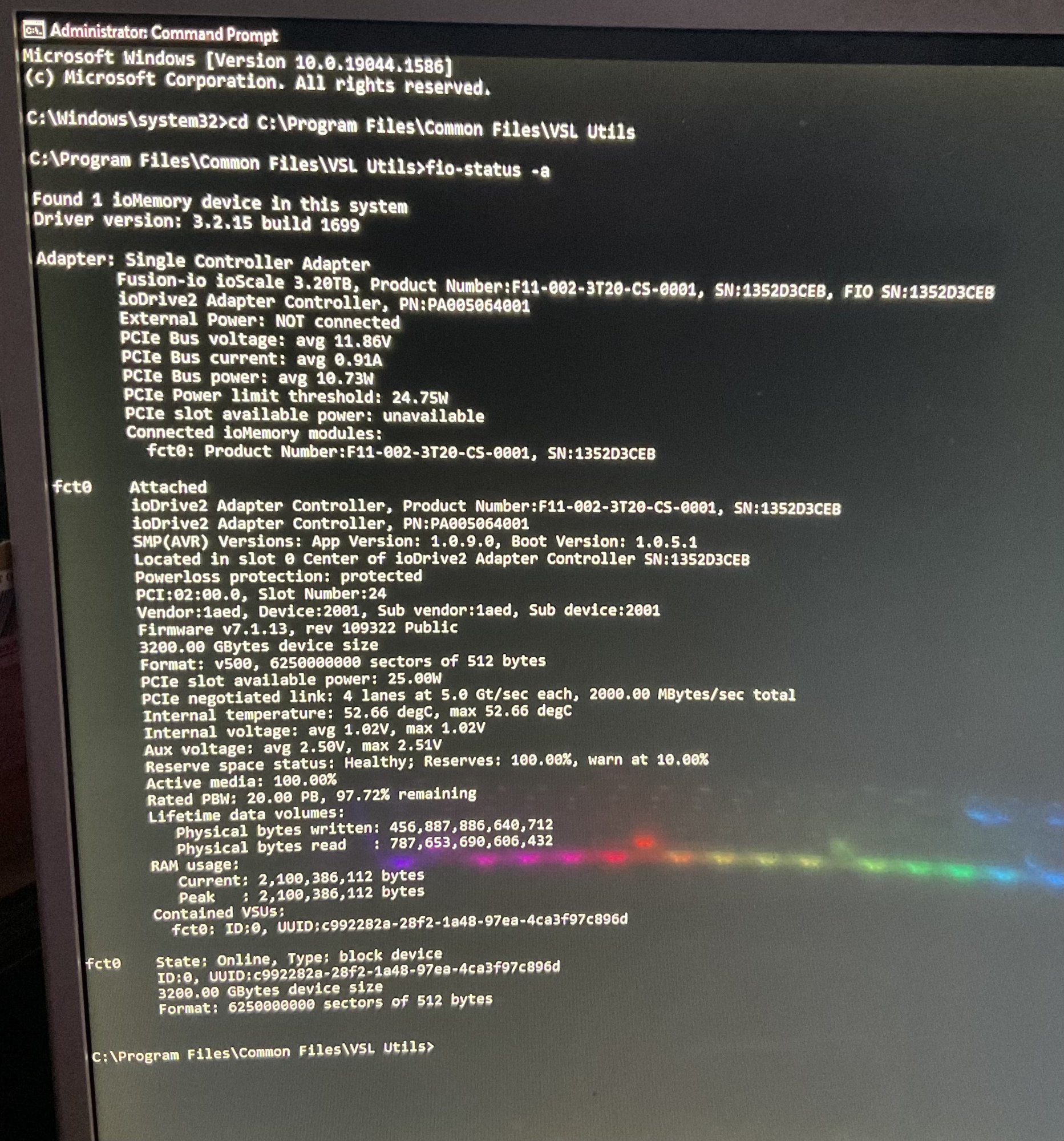

Well it’s here looks brand new and 97.72% remaining
