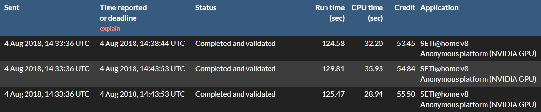

Also, the updated Cuda app is Linux only right? Or am I running the wrong app for my 1080 in windows? My 1080 is taking around 4 minutes per task at stock. Sorry, I have all AMD cards so I haven't really figured the 1080 out yet.
Yes. This is the combo that gives the best PPD. Windows optimized apps is a slower than Linux optimized apps.
