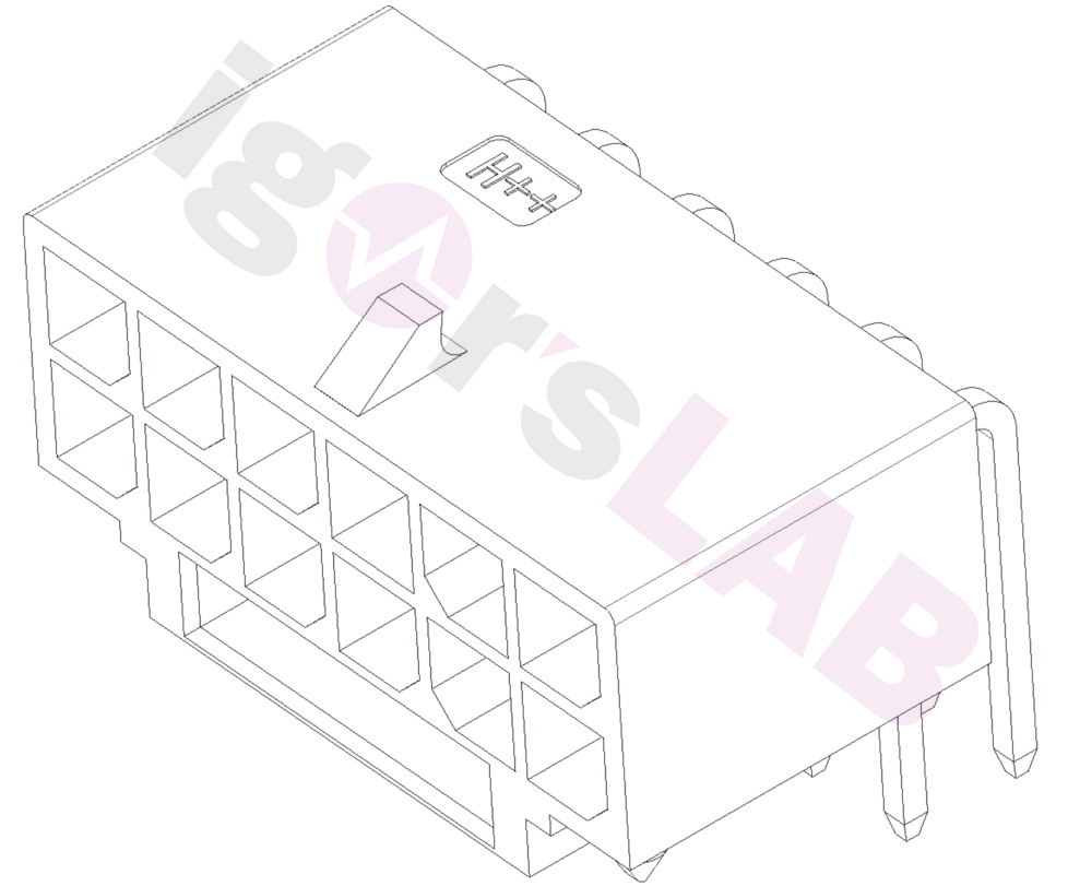

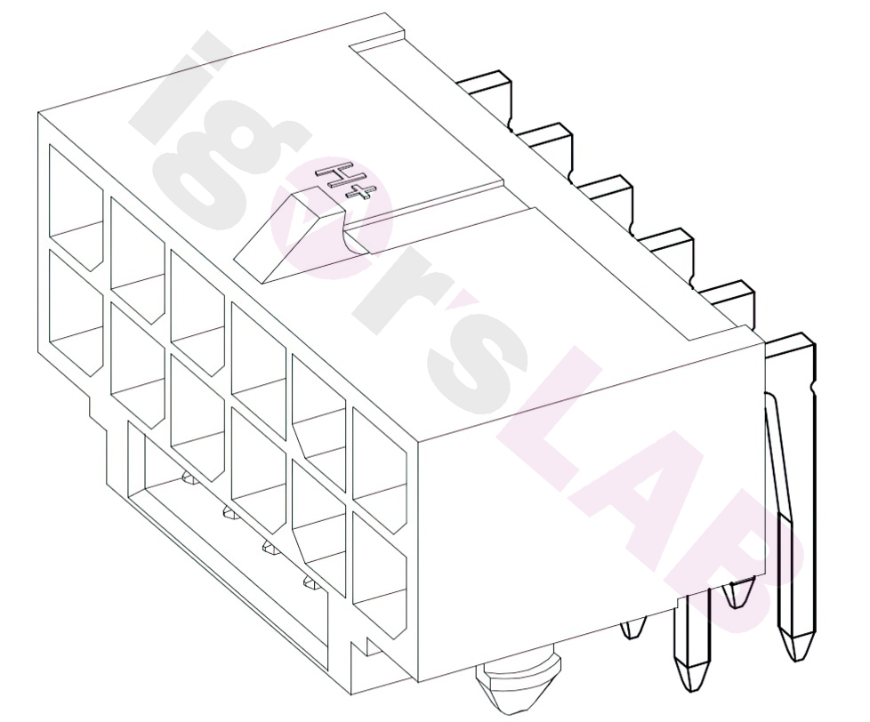

I mean, it really looks like a joke to call it a new connector though.
Old header:
New Header:
I played a game of "spot the difference", and apart from the "H++" and more rounded pins, I didn't see anyhting.
I was expecting the keying to be different, but it looks exactly the same, so the intent must be for these to be backwards compatible.

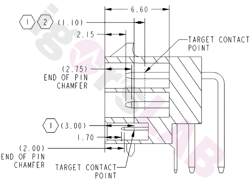

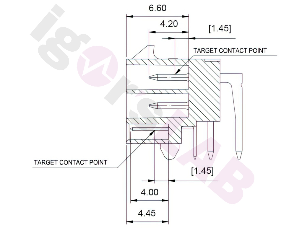

Then I got to the dimensions:
Old:
New:
So, it is dimensioned differently...
This is what I would call a "tolerance stackup exercise and design revision" not a new connector.
I bet they are even backwards compatible...
Old header:
New Header:
Old:
New:
Larger pins that stick out further with a clip that has more of a tactile bite to it, it probably adds an extra penny's worth of copper in there and the problem goes away.
Compatible dimensions, same keying- looks like the only real difference is that the sense pins will be shorter so they won't make a connection unless the plug is fully seated.
(Edit: and the power pins are longer)
Which, uh... Seems like something that should have been accounted for with 12VHPWR to begin with?!? Seems pretty common-sense from an engineering perspective that a connection with sense pins ought to be designed so the sense pins contact last to avoid false positives for "the thing is plugged in" but at least they're fixing it now.
So what does this mean for all the existing 3.0 PSU's on the market? Is the PSU-side connector also changed?
edit: It's backwards compatible.
Old header:
New Header:
Old:
New:
The power delivery pins are also longer and slightly wider
