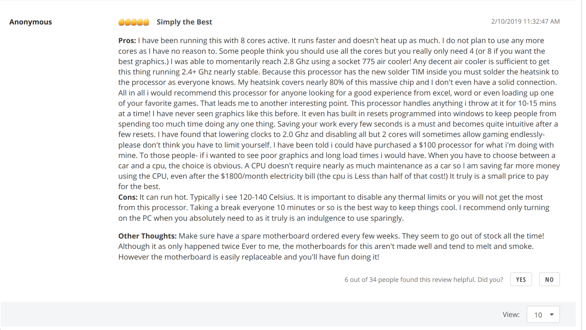

So we are discussing this ridiculous slab of a pointless over priced rebuttal to Threadripper. Does anyone here on the forums actually have or going to buy one?
Here is an awesome review from Newegg! I would totally give this guy 5 eggs for this review.
