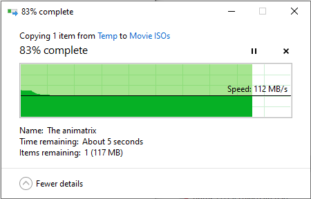

Here's my 1GB Intel NIC on a ~700MB file on my 1GB LAN from a source and destination that are capable fo maxing out typical real world transfer rates.
from my PC Intel NIC to NAS
from NAS to my PC Intel NIC

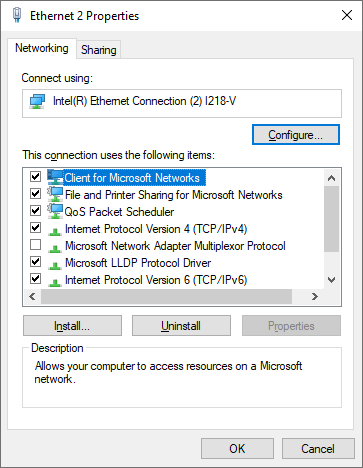

NIC properties (all default Windows 10)
Simple unmanaged Trendnet 8 port 1Gb switch makes the connection between my X99 based motherboard's Intel NIC to my cheap $150 QNAP 231P NAS.

Here's my 1GB Intel NIC on a ~750 mb file on my 1GB LAN from a source and destination that are capable fo maxing out typical real world transfer rates.
from my PC to NAS
from NAS to my PC
Simple unmanaged Trendnet 8 port switch bridges the connection between my X99 based motherboard's Intel NIC to my cheap $150 QNAP 231P NAS.

112MB/s == 896Mb/s
Pretty close, what's the problem exactly?
