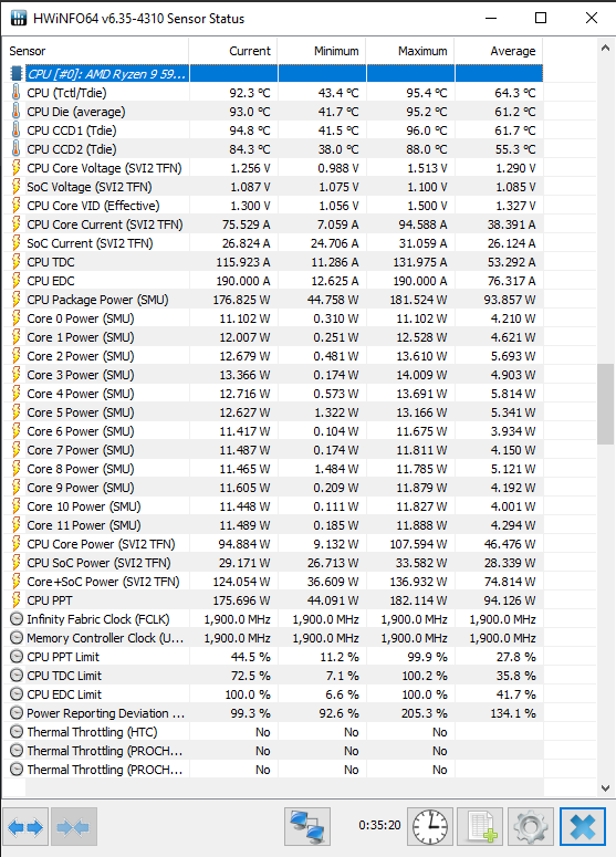

Seems like I got really unlucky with one of the CCD's on my 5900x.
Using a NZXT X63. Running pump and fans at around 50-60%, but no difference at 30% or 100%. Tried to reseat the cooler 4 times in different orientations, but always the same.
This is running at locked 1.256V (1.3V in bios with LLC at 2) running Cinebench R20.
CCD1 is running locked at 4.3Ghz and at a whopping 95°C
CCD2 is running at 4.7Ghz and doing ok at 84-85°C.
I can max overclock CCD1 to 4.4Ghz at 1.3V with highest LLC setting. It hits 100°C at this setting.
CCD2 can do 4.75ghz at same voltage and sitting just below 90°C.
Have you guys ever seen a CCD this bad before?

This is Cinebench R20 multicore load, but the 10°C difference is there always in multithreaded loads.
If I run PBO "overclock" it's also over a 10°C difference. My problem is the high temps on CCD1. CCD2 seems pretty good.
Also seems to only boost to 4,75ghz in single core loads on Cinebench R20 on CCD1. Seems a bit low.
Is there a way to force it to use CCD2 first?

Yeah, I've done 4 remounts and the cooler in different orientations. Always the same 10°C difference. Mounting pressure seems good also.
I'll try to change around the standoffs, just to rule out everything.
