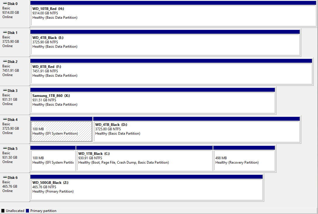

I am using 5 SATA drives and 2 M.2's and the M.2's are Disk 5 & 6 in Disk Management. I posted a screenshot of it on the previous page.
this is my other PC that I am currently using for my friends Chia plotting and farming.
I migrated my main PC's OS to the 980 Pro so I wouldn't have to re-install everything on this machine as it will become my main PC eventually and I wanted the setup to be identical.
But this is how the drives show up, 2x M.2's and 6 USB drives.

OK I was not on my main PC at the time I said this. But my PCIe storage is showing as Disk 2 (my 2 SATA HDD's are disk 0 and 1 and plugged into Sata port 0 and 1.
So, with my system and Zepher It does seem that it starts with your SATA drives then goes to PCIe drives and is only numbered up to as many as you have installed.
As long as you know which port your drive is plugged into you should be able to know what disk you are installing on even if they are all the same size.

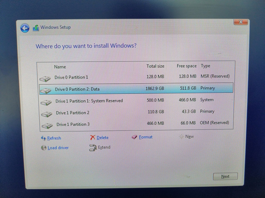

Here's some random Internet picture that clearly shows multiple drives. If you don't like the partitions you just click on them and delete, or hit shift+f10 and bring up diskpart to select and clean them (preferred).

Secondly, the installer does let you choose which drive to install on ... so what are you talking about?
