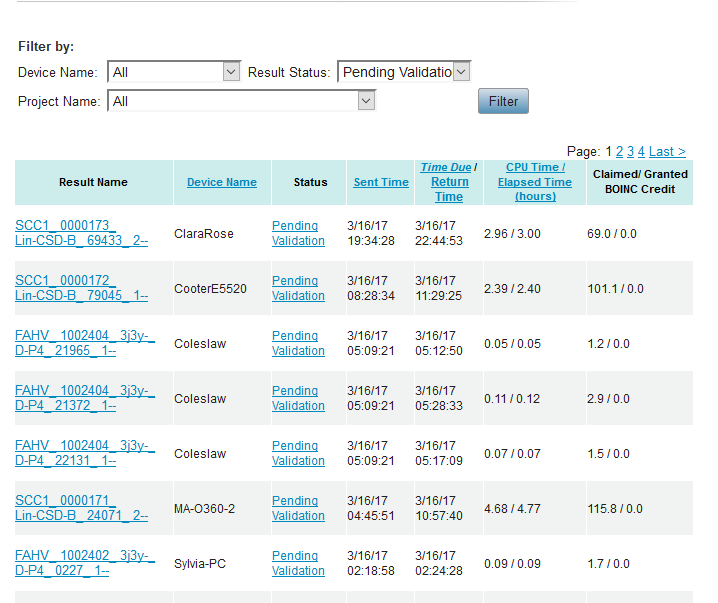

pending validation? pending verification? running different sub project? running more of one sub project than you had been previously? Results returned does not mean verified, so the numbers can easily shift. What you need to look at is number validated. Let us know how those numbers look. Also, points for each sub projects work can shift a bit since they use a modified version of BOINC's credit new system.
Not easy... you have to look in your account's results page and filter them.
Here is an example
Well crap. I've got 12 pages of pending verification.
So you're telling me if I were to stop crunching on all my boxen right now that I would still be generating points as those results are validated?
That is what I'm saying. Some (well most) sub projects require a wingman to validate the work. However on the server from time to time will require systems to be double checked just to verify they are still a "reliable host" and thus is where the verification work comes in.
