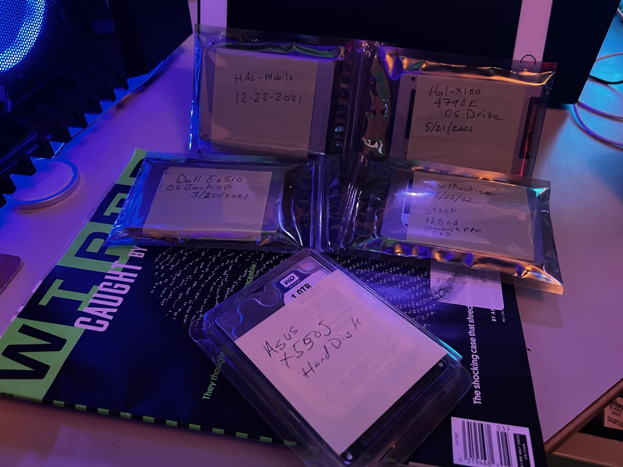

If you look at the image I posted, the HAL-Mobile SSD is the oldest one I have, got it used in 2012, it was powered on 24/7 from 2012 till I put it into my laptop a few years ago and then sold the laptop and pulled the drive out last year.
It's a Crucial 120 or 128GB model.
And I haven't had an SSD fail on me yet, I usually upgrade to a larger one and the smaller one still works fine.
