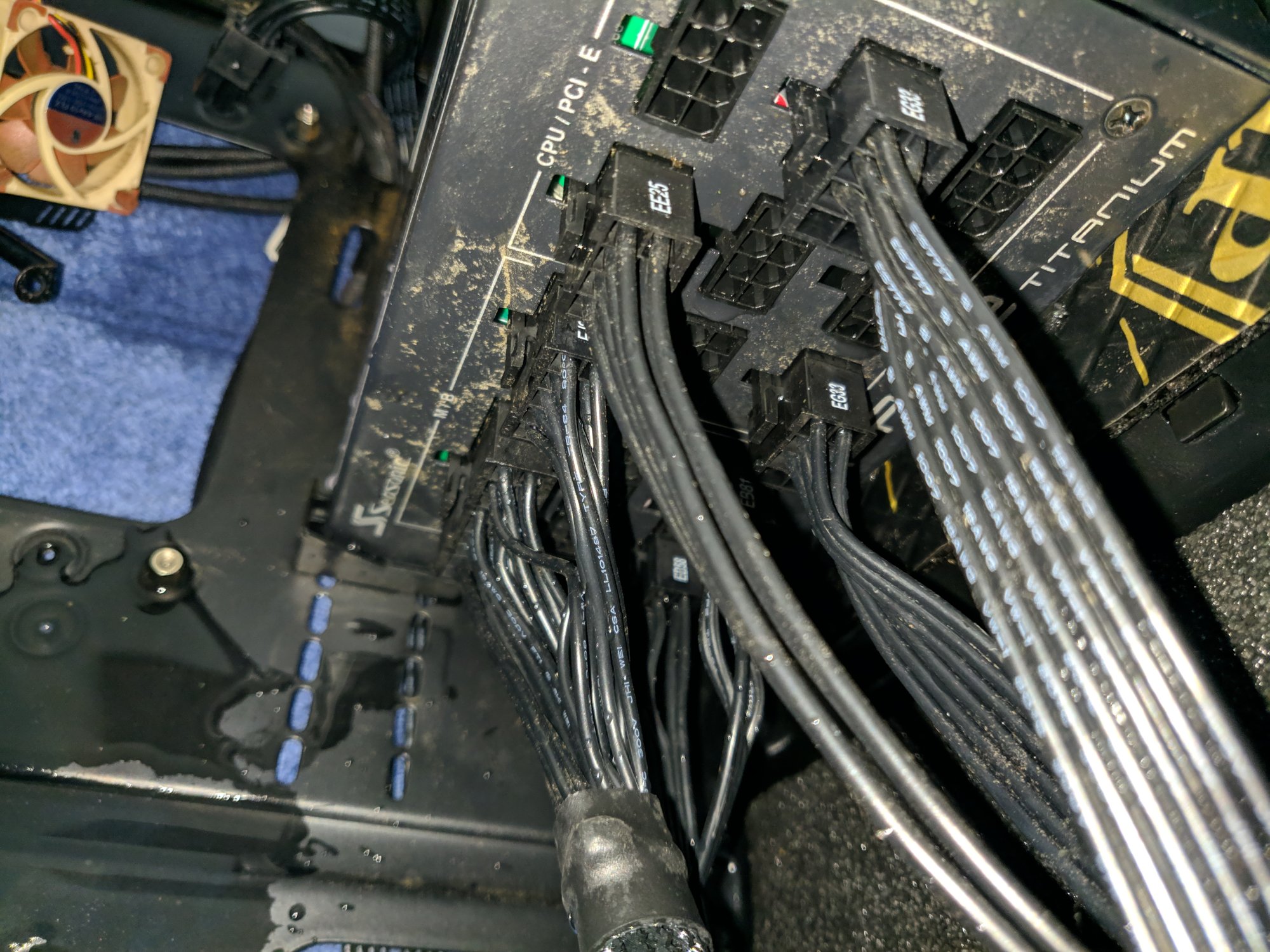

Since i expect them to die without burning the house down i´ve only retired them if the system starts to crash (the intervall of crashes shortens = psu dies)
Or after a flood:
Nigirin contact spray helps with fluid spillage (or cleaning sandy/dirty pcie slots) - but this is high wattage and the risk is simply too great
Or after a flood:
Anything electronic that's subjected to submersion must be completely disassembled and cleaned out with anhydrous solvent, dried extremely well and tested with lower voltage (at least the light bulb test) to make sure its OK. This takes way too much time and with the price of PC parts it's better to toss/replace.
