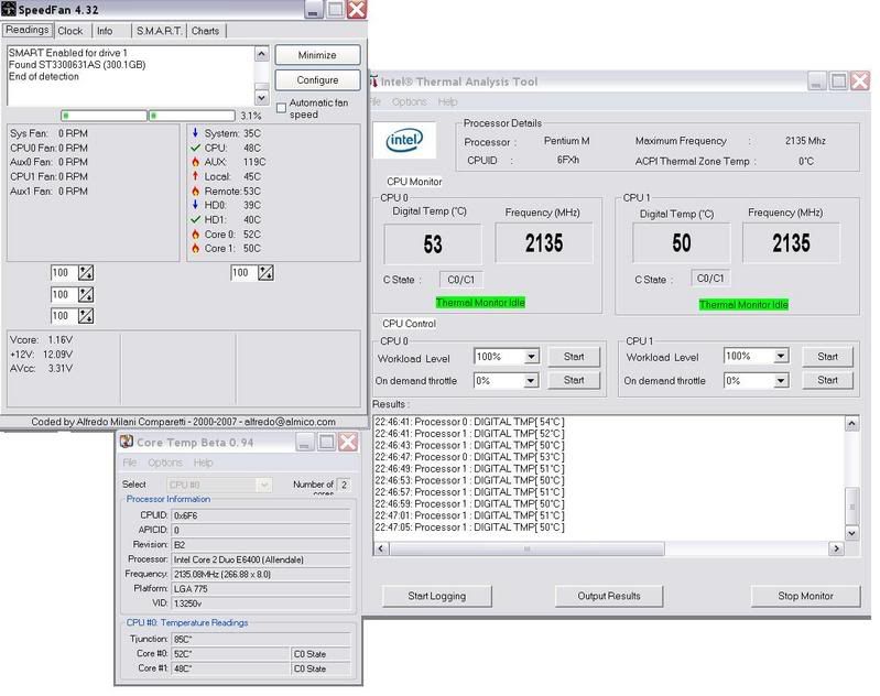

Okay, I just got my replacement vid card back and my comp is finally up and running. While I was waiting for my card, I modded my case to have a lot better airflow, as well as reseated my waterblock with some new AS5. I know the paste hasnt really "set" yet but these temps at idles are ridiculous! bios says 53. I really want to OC so im looking for idle temps in the low 30s.
WB - TDX
Pump - D5
Rad - X-Flow Stealth GTS 240 Black Ice
Res - Swiftech Micro

Using Tat to load both cores to 100%, temps reached 80c in about 2 minutes. Something is seriously wrong :(

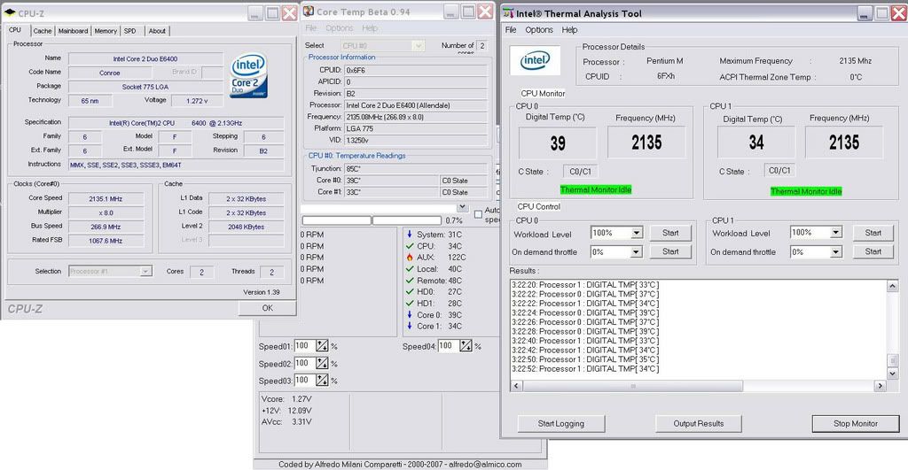

i have that water block and a similar motherboard. i bet 100 points i know whats wrong. that block is tooooooo friggen big. i had to grind part of the edge off about 1/8" and 1/16" deep so the block doesnt hit the capacitors near the cpu, i bet its not making proper contact, though you would probably never see the 1-2mm difference in height across the block. other then that i love the TDX heh

After HOURS of sanding the WB, i finally got it to clear the capacitor. I have remounted my WB at least 15 times now (i would consider myself a pro:p )
I wish my idle temps were slightly lower but with the load temps and the delta im pretty satisfied. The AS5 hasnt really set either.
Idle:
http://i2.photobucket.com/albums/y5/DJS3/DiagnosticReportIDLE-1.jpg
Load:
http://i2.photobucket.com/albums/y5/DJS3/DiagnosticReportLOAD-1.jpg
idle is from 33-40, load is from 41-47.
