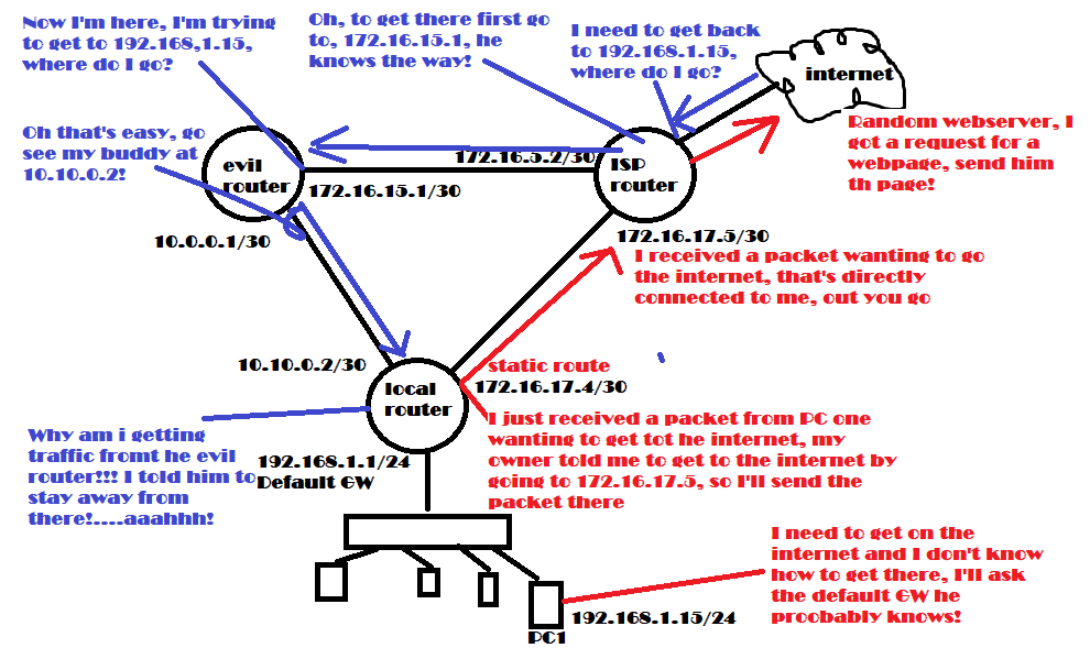

static routes don't block anything....static routes just tell a router what hop to go to next.....that's it. I doesn't prevent asymmetric routing, it doesn't mean that they can't get to the same address via a different way, static routes shouldn't be used for security purposes, that's not their job. That's a FW's job. start at the bottom right, and move up counter clockwise to follow. FYI In Real Life, private IP's would never be on the internet, and instead would be NAT'd to a public IP, but I eliminated that for simplification, the concept is the same.
ISP middle men don't do anything near as I can tell. That's why I don't use them.
.View attachment 325293
I assume the image is made for me - thank you! Asymmetric routing seems very insecure...

Routing has nothing to do with security, it's only job is to get packets from one destination to another, Asymmetric isn't insecure, it can be inefficient and a PITA to troubleshoot, but again, no one typically uses routing as a security measure, i'm sure there are exceptions, but that's not what it's designed for.

Private IP's aren't publically routable on the internet, you'll sometimes see them in traceroute because you'll hit a routers public IP and than they will NAT that to a private IP(internal to their network), it may bounce around their network for a bit, than it will again be NAT'd to a public IP before going from on AS to another, and they may NAT back to a private IP as well, it's not that uncommon.
I do understand that Static Routing shouldn't be used for security purposes, but aside from VPN's, what are alternatives? With Static Routing you can at least prevent initial connections to evil routers...
Static routing IMHO shouldn't ever be used for security reasons, and could actually even be considered a security risk. How? Arp spoofing that one IP you think is safe...
