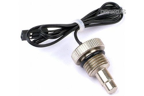

I'm looking through available fittings, and was wondering if you guys had thoughts on the following:
Is there any reason this style of fitting, with the extended sensor:
would be better than these, shorter versions that look more like traditional stop fittings?
Ideally, I'd love to just replace a couple of stop fittings to get water temps and the second model seems it would be less restrictive on the loop.

I'm using the Monsoon plug that is similar to the second one you have posted and have no complaints.
