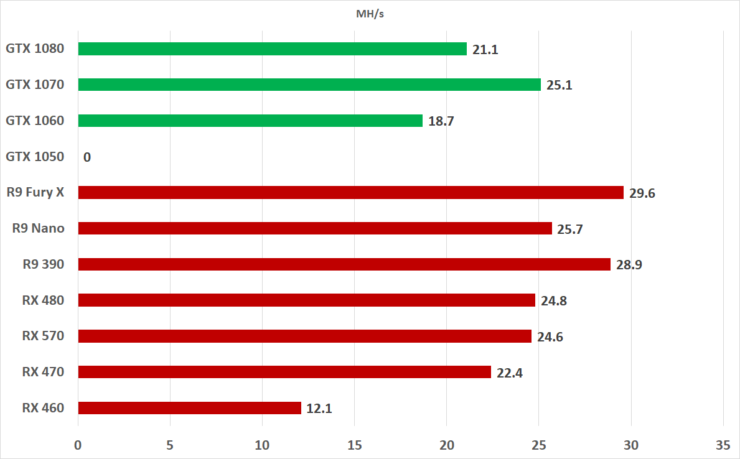

Just look at mining, that is pure compute, why the hell is Vega topping out at 43 mhs? That is pure compute, I would like to see it when something other then Eth, just to rule out bandwidth bottleneck, something like Zcash which it only gets 430 sols (after modding) which is lower than a gtx 1070, 450 sols (after modding)! There ya go, its compute throughput issues rear their ugly head again. We also see this problem is synthetic compute tests, so its not a one time thing.
Etherium hashing rate is well known to be predominantly memory bandwidth and memory latency bound. I have no idea why you would mention it as evidence of sub-par compute performance. Zcash is also apparently a memory bandwidth bound workload, so I don't see how it would constitute evidence of Vega's compute performance? According to Anandtech's compute performance testing and TechGage's compute performance testing, I see nothing to suggest RX Vega has issues with compute performance?
Zcash is not memory bound, how do you explain a rx 580 getting 300 sols? It has similar bandwidth to the 1070 after modding. Oops didn't know that? Also rx580 are back down to gtx 1060 in Zcash performance, and gtx 1060 has much less memory bandwidth after modding. Sorry your understanding seems to be limited when it comes to where bottlenecks are with mining.....
Zcash is described as memory hard directly on their own webpage for heaven's sake.

about memory hard, you didn't read what Equihash algo has do you
The memory requirements for testnet mining are currently set very low, because the implementation is not optimised. So currently, anyone who was mining before can still mine.
They aren't talking about bandwidth they are talking about memory amounts! Your assumption that it was bandwidth is a fallacy. I didn't even need to look it up because I have been mining different equihash coins on multiple rigs and know what is going on.
again, you didn't know this, its within your own link.
Once we have optimised the implementation (#857), we will bump up the memory requirements to around 1 GB of RAM (#856),
https://z.cash/blog/why-equihash.html
nowhere do they talk about bandwidth lol, yeah thought so, no where! cause its not at the moment and won't be for at least a year not even on 4 gb cards, let alone 8 gb, that will be 2 years down the road.
So another one to add to your list, of being wrong? You are assuming things without understanding the fundamentals, yeah AMD marketing will get ya all the time if you do that cause you assume they are telling you the truth or in this case eluding by telling others half truths. Don't sit here and tell me that I don't know what I'm talking about and its incoherent when you can't even read whats inside of your own link (well linked to within your link).
